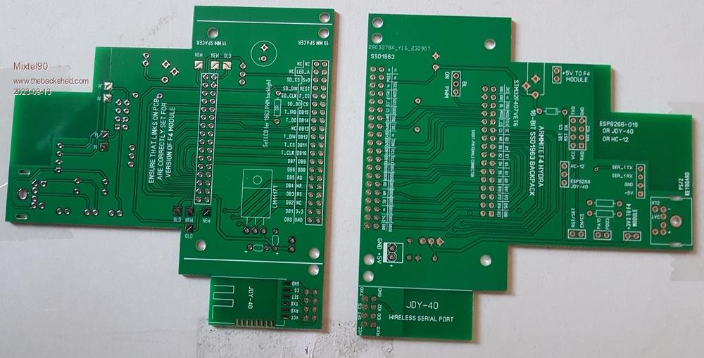

As mentioned in another thread, I've been sorting out a "backpack" that allows a Armmite F4 to be mounted behind a SSD1963 without losing access to the IO pins.
The prototype boards have just arrived!
Just some connectors to arrive then it'll be playtime. :)
The JDY-40 is an adapter board that is cut off. Also, two lines indicate where to cut the board to fit it behind a 4.3 inch display.
I have some ides for a version 2, but nothing in the pipeline yet.

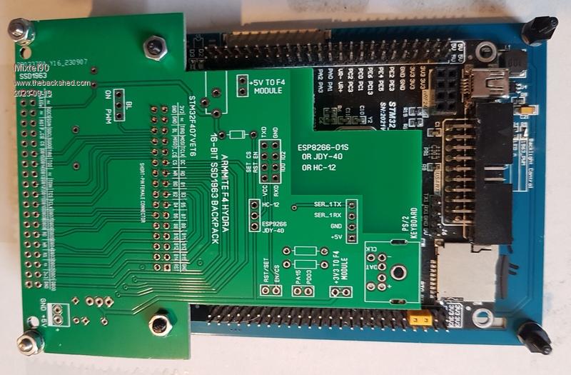

Dry assembly run so you can see the general idea:
It's intended to have two short pieces of PCB material from the RH corners of the F4 to the two little pillars on the rear of the display. That stiffens the assembly to prevent any risk of contact between the rears of F4 and display.
It's designed to be mounted behind a front panel so there are 5mm spacers on the front of the display PCB. The total depth of the assembly from the rear of a front panel to the rear of a back stud is approximately 32mm, so it's pretty compact.

I got my LCD connectors today and panicked a bit when the system didn't work first time. It helps if you remember to connect the backlight to the PWM output, doesn't it?  :)
I've not fully equipped it yet, but so far there have been no problems. There are changes that could do to be made really, but nothing serious.

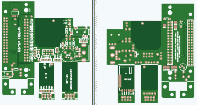

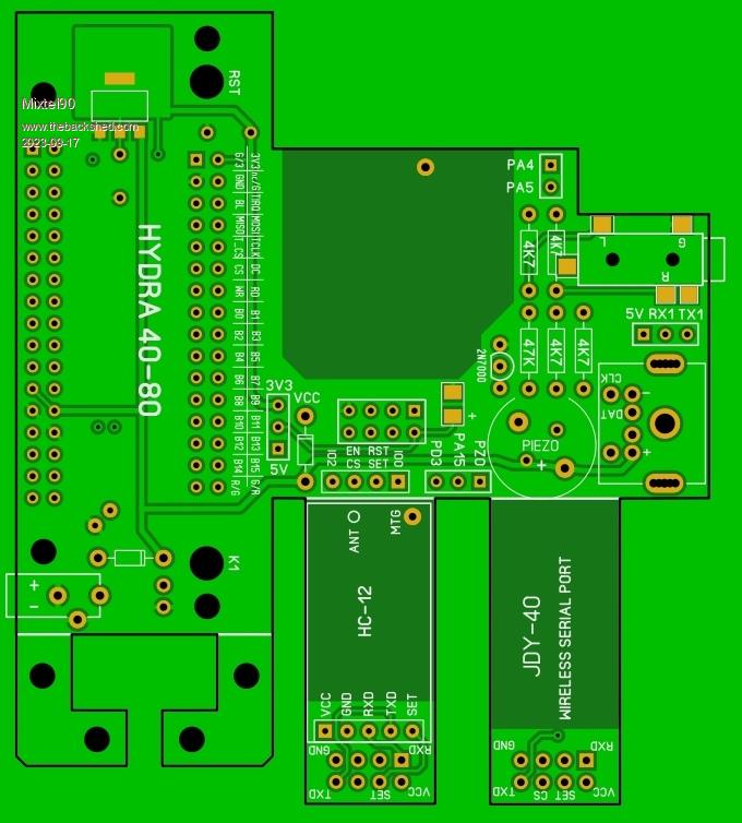

This is the version for the 4" 800x480 display:  The Hydra 40-80
Gerbers:  Hydra 40-80.zip
No instructions yet, I've not got around to it. :)
This one is a more complex shape than usual and is a 4-layer board so it will very likely cost a little more to get it made.
Edited 2023-09-17 22:38 by Mixtel90

Posts: 9084
Posted: 04:01pm 17 Sep 2023
As far as I can tell it's ok. :)  You need x-ray vision to see the two inner layers.
The little L-shaped pieces support the loose end of the Armmite on 5mm pillars on the back of the display. The two long, narrow boards are optional COMM modules. All these need to be cut off, but I've allowed a little leeway so that they could be cut with a fine saw or probably even a junior hacksaw without encroaching on anything important.
The "proper" assembly is intended to be dome like the Hydra board, except that the L-shaped pieces are supplied.
If you power from the USB connection:
Fit a wire link from the serial port 5V pin to the Hydra 5V pin. Ideally you shouldn't fit the regulator - I forgot to fit a link here. What will happen is that the outputs of the Armmite regulator and the Hydra regulator will be in parallel. That shouldn't cause a problem as the load is nowhere near the full load of a single regulator so current scaring isn't an issue. If you haven't actually placed the order yet I'm quite willing to include a link and re-do the gerbers.
If you want to power from the external 5V connection:
You will need the regulator as it powers the Armmite at 3V3.
Note that you always need 5V to the board from somewhere if you want the PS/2 keyboard.
Posts: 9084
Posted: 06:33pm 17 Sep 2023
I've made a couple of slight changes so here are some new gerbers, if I'm not too late.
1: There is now a removable link to disconnect the 3V3 feed to the Armmite.
2: I've added a Schottky diode to prevent powering the Armmite from the Hydra 5V line. This will protect the USB input but will lose a bit of voltage to the display. If that's a problem it can be linked out. The Armmite can now be powered from either USB or at 3V3 via the Hydra regulator.
3: I've corrected the Pin 1 position indication on the display and Armmite connectors.
None of these are deal breakers, but nice to get sorted early.
Hydra 40-80.zip
