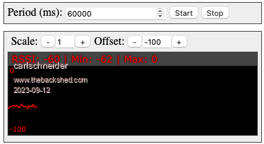

The trending over time gives one an idea of what is happening in the WiFi environment the Pico W finds itself in, as well as what sort of signal strength is being seen by the Pico W for the SSID of interest.

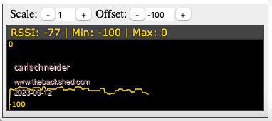

I have noticed that the Pico W in the Breakout Board appears to have a worse RSSI than the Pico W lying on the desk.
An example of the graphing below, firstly the Pico W lying on the desk and second the Pico W plugged into the breakout board.
Pico W in breakout board

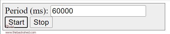

Thanks Carl for the nice utility!
I have scanning ongoing and the results are nicely presented on the console.
However, I am not able to get any results to the browser.
The layout of the page is slightly diferent from what you showed in your post! Start and Stop at the bottom instead of to the righ of the "period" window.

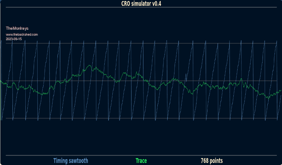

Hi Carl,
Have you considered using csv and a browser canvas?
It works fine for me.

  TheMonkeys said  Have you considered using csv and a browser canvas?
Can you provide an explanation of what this means--or links to explanations?
TheMonkeys
Joined: 15/12/2022
Posts: 59
Posted: 12:00pm 15 Sep 2023
I'll post up an example in the morning.
