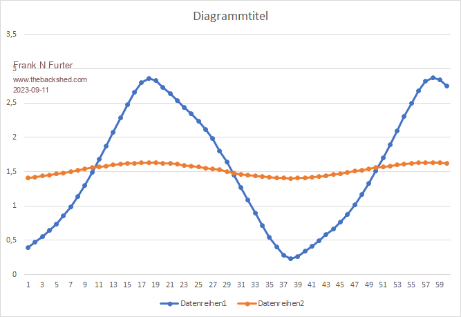

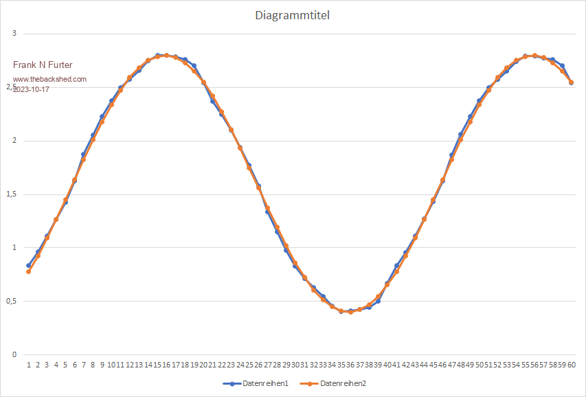

My problem is that the voltage curve is distorted, because I can tap the voltage only after a transformer.
Don't you think it would be better to detect the zero crossing and then superimpose an ideal sine wave over it?
This is what my measurement currently looks like:
Blue is the mains voltage (after the transformer) and raised into the positive range (1V52), red is the current waveform (here from a 1800W hairdryer).
How would you evaluate these measurement results now???
THANKS!
Frank

Posts: 9085
Posted: 08:02am 11 Sep 2023
You can never be sure of the wave shape from the mains supply. It varies with the load at any one time as well as with whatever transformers are feeding your site. It's always distorted to some extent.
Because of power factor there is rarely any relation between load voltage and load current unless the load is purely resistance heating (no motors).
Basically, if you want reasonable accuracy work with either voltage at the load terminals or current into the load but not both unless you really *have* to calculate power into the load. Try to avoid that if you can, for that way madness lies. :)
The "proper" way to do it is to use a True Watts Transducer. They are a current transformer and voltage monitor combined and produce a control voltage or current that is proportional to the load Watts, no matter what the power factor is. They cost rather a lot though, being industrial gear.

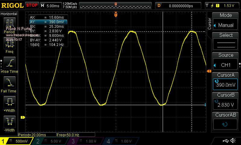

  disco4now said  The LOG CSUB compiled with the new header file as required from V5.07.05 Beta13 onwards.
The mains waveform shown above is too distorted. Mains distortion rarely exceeds 5%. Put a resistive load on the transformer output, 10% of it's rated power will do then see if it looks better.

I also started out with using a transformer to isolate mains voltage.
But the transformer showed similar distortion as yours.
I tried (resistive) loading the transformer, but until the load was really close the the transformer rating (several Watt) it remained distorted, and worse, it showed phase lag.

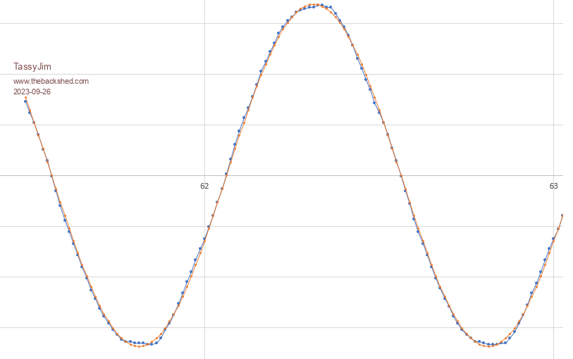

Posts: 6586
Posted: 09:59am 11 Sep 2023
I get reasonable waveforms using a small toriodal core transformer lightly loaded.
With your two waveforms.
subtract the mean to get them centred about zero.
multiply the two arrays element by element to get instantaneous power.
the mean will be positive or negative depending on direction.
I will try and put up some code and resulting graphs tomorrow some time.

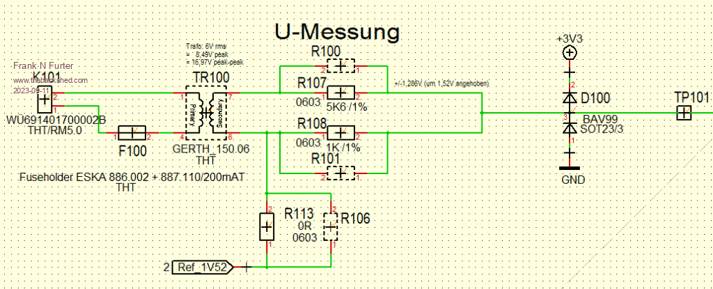

Can you tell me which transformer you used for this? I would be very interested in the exact type...
@Mixtel90:
With a constant load, the phase shift should also be constant and can therefore be calculated out...
I have now tried reducing the load on my transformer - the curve now looks better. However, the amplitude (also because of the downstream low-pass) is now much too low and everything would have to be adjusted again...
Frank

I was amazed to see that you can use a common mode choke (ferrite material, not iron core) to measure mains voltage. The trick is to run it really low current, since it represents a really low impedance, and saturates easy. And terminate it in a virtual ground or other low impedance. To be usefull you need a common mode choke with a lot of turns on it.
using common mode choke
I just tried it with a 33mH commercial choke, and it actually works.
When you drive the common mode choke core too hard, it shows similar distortion as Frank's waveform. Maybe this is something Frank can try as well. Just put a lower voltage at the input of the transformer (33k/33k voltage divider so you have 115V to drive the transformer).
Never too old to learn...

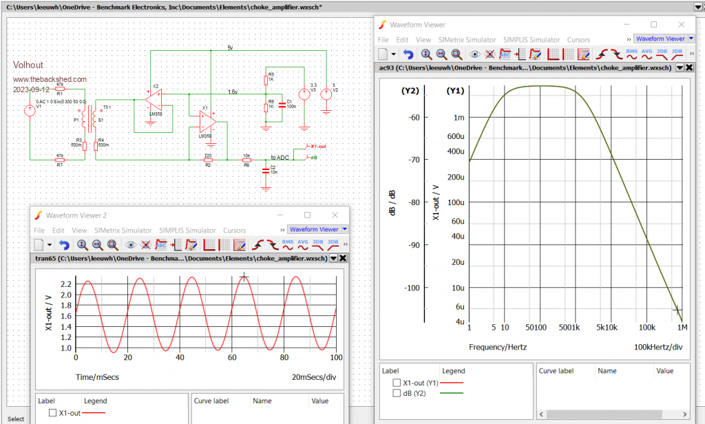

Posted: 02:37pm 11 Sep 2023
Simulation shows that something like this should work to measure mains voltage. I will try to prototype (build actual circuit) tomorrow.
