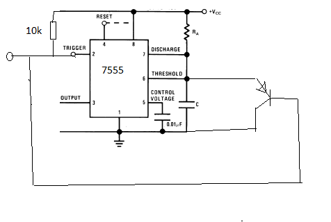

I am the last person to comment on programming styles but I am sure you should be able to detect most if not all system failures without the need for external hardware.
If you do use a 555, make sure it is a variant that runs on 3.3V such as the 7555
My choice of circuit would be
Your circuit should work.
In either case, a longer pulse is desirable.

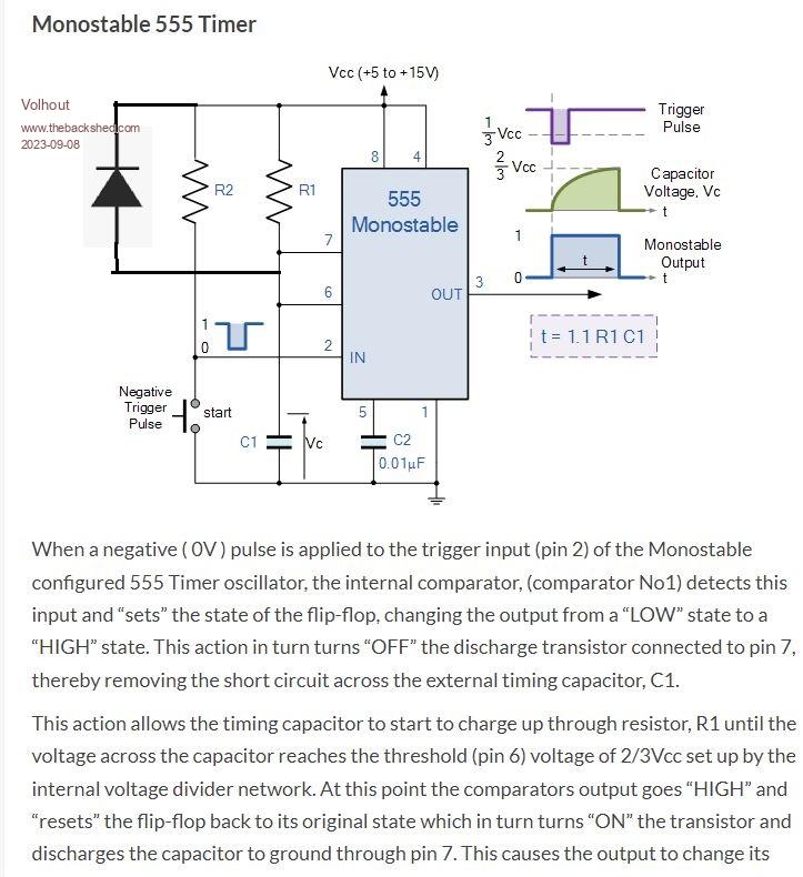

Posts: 6199
Posted: 09:23am 08 Sep 2023
EDIT: ignore the text below, you need a 74LVC123 (retrigerable monostable) to do this, 555 won't work since it cannot re-trigger). But the technique is usable if you choose for a 74xx123 chip.

Pin GP14 connects to ICM7555 pin 2 directly.
The output (ICM7555 pin 3) connects directly to the reset pin (RUN pin). At startup the capacitor is empty, causing the reset pin to be high -> the picomite starts up. It may be desirable to add a diode from the capacitor to 3.3V to make sure the capacitor also discharges fast at a power cycle.
The monostable has a timeout of 1.1 x R x C.
Edited 2023-09-08 19:40 by Volhout
