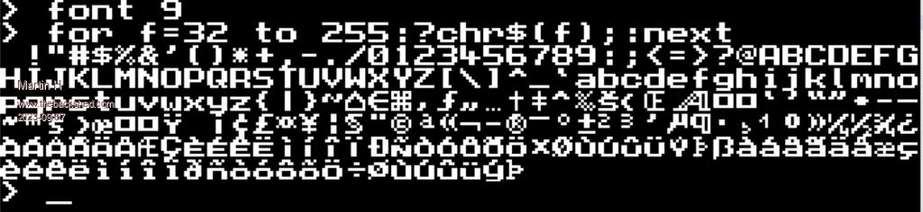

my Windows default graphics program is Paint.net.I looked at GrafX2.
I'm probably too used to the Windows Gui, so it's difficult to get used to it at first.
But GrafX2 comes with a couple of nice AMIGA Style 8x8 fonts, with which you can certainly do nice things on the *Mites.
here a first translation:
' font_Classic
' Font type    : Full (224 Characters)
' Font size    : 8x8 pixels
' Memory usage : 1792
DefineFont #9
E0200808
00000000 00000000
18181818 00180018
006C6C6C 00000000
6CFE6C6C 006C6CFE
7CD07E10 0010FC16
3058AC46 0084CA64
76386C38 0076CCDC
00301818 00000000
30303018 00183030
18181830 00301818
7C385400 00005438
7E181800 00001818
00000000 30181800
7C000000 00000000
00000000 00303000
180C0602 00C06030
D6CEC67C 007CC6E6
18183818 003C1818
3C0606FC 00FEC060
3C0606FC 00FC0606
D8D8C0C0 001818FE
FCC0C0FE 00FC0606
FCC0C07C 007CC6C6
180C06FE 00303018
7CC6C67C 007CC6C6
7EC6C67C 007C0606
18180000 00181800
18180000 30181800
6030180C 000C1830
007C0000 0000007C
0C183060 00603018
1C0606FC 00300030
AA9A423C 003C409C
C6C6C67C 00C6C6FE
FCC6C6FC 00FCC6C6
C0C0C67C 007CC6C0
C6C6C6FC 00FCC6C6
F8C0C0FE 00FEC0C0
F8C0C0FE 00C0C0C0
CEC0C67C 007EC6C6
FEC6C6C6 00C6C6C6
1818183C 003C1818
0C0C0C1E 0078CCCC
F0D8CCC6 00C6CCD8
C0C0C0C0 00FEC0C0
D6FEEEC6 00C6C6C6
DEF6E6C6 00C6C6CE
C6C6C67C 007CC6C6
C6C6C6FC 00C0C0FC
C6C6C67C 0076CCDE
C6C6C6FC 00C6C6FC
7CC0C07E 00FC0606
1818187E 00181818
C6C6C6C6 007CC6C6
C6C6C6C6 0010386C
D6C6C6C6 00C6EEFE
386CC6C6 00C6C66C
3C666666 00181818
30180CFE 00FEC060
30303038 00383030
3060C080 00060C18
18181838 00381818
00663C18 00000000
00000000 00FE0000
00183030 00000000
067C0000 007EC67E
C6FCC0C0 00FCC6C6
C67C0000 007CC6C0
C67E0606 007EC6C6
C67C0000 007CC0FE
7C30301C 00303030
C67E0000 7C067EC6
C6FCC0C0 00C6C6C6
18380018 003C1818
18380018 F0181818
CCC6C0C0 00C6CCF8
30303030 00183030
D6EC0000 00C6C6D6
C6FC0000 00C6C6C6
C67C0000 007CC6C6
C6FC0000 C0C0FCC6
C67E0000 06067EC6
E6DC0000 00C0C0C6
C07E0000 00FC067C
307C3030 001C3030
C6C60000 007EC6C6
C6C60000 0010386C
C6C60000 006ED6D6
6CC60000 00C66C38
C6C60000 7C067EC6
0CFE0000 00FE6038
60303018 00183030
18181818 00181818
0C181830 00301818
CCD66600 00000000
C66C3810 00FE8282
FEC0603E 003E60C0
28FEAAEE 00EEAAFE
00000000 00603030
3C18180E 00F01818
00000000 00D86C6C
00000000 00540000
107C1010 00101010
107C1010 0010107C
00CC7830 00000000
2050A844 0014AA54
C07E386C 00FC067C
C0603000 003060C0
9C90907E 007E9090
02010000 003E0A05
9454B47C 001E14F4
C6C6FE00 0000FEC6
C6C6FE00 0000FEC6
00183030 00000000
00301818 00000000
00366C6C 00000000
00D86C6C 00000000
7C380000 00000038
7C000000 00000000
FE000000 00000000
587C3400 00000000
54545CF4 00000000
603C1028 00780C38
060C1800 00180C06
B66C0000 006EB0BE
C6C6FE00 0000FEC6
C6C6FE00 0000FEC6
3C660066 00181818
00000000 00000000
18180018 00181818
603C1818 18183C60
7830301E 00FE6030
6C6CBA00 000000BA
7C386CC6 00107C10
00181818 00181818
48B0E07C 00F80C34
00006C6C 00000000
A2BA4438 003844BA
241C0418 0000001E
6C6C2412 00001224
FE000000 00000202
7C000000 00000000
B2AA7438 003844AA
0000FE00 00000000
18242418 00000000
187E1818 007E0018
806010E0 000000F0
10E010E0 000000E0
00603030 00000000
7E363636 0080C062
CACACA7E 000E0A7A
30300000 00000000
20000000 00300830
20A06020 00000020
6C6C6C38 00000038
36362448 00004824
30988C86 028ECA68
30988C86 0E84C26C
38CC26C2 02CE6AF8
70180018 007CC6C0
C67C3860 00C6FEC6
C67C380C 00C6FEC6
C67C2810 00C6FEC6
C67C7ABC 00C6FEC6
C67C006C 00C6FEC6
C67C2838 00C6FEC6
FC90503E 009E9090
C0C0C67C 70187CC6
C0FE1830 00FEC0FC
C0FE3018 00FEC0FC
C0FE6C38 00FEC0FC
C0FE006C 00FEC0FC
18001830 00181818
30003018 00303030
30006C38 00303030
303000CC 00303030
F666667C 007C6666
E6005834 00CEDEF6
C67C1830 007CC6C6
C67C3018 007CC6C6
C67C6C38 007CC6C6
C67CBC6E 007CC6C6
C67C006C 007CC6C6
183C6600 0000663C
D6CE6C3A 00B86CE6
C6C61830 007CC6C6
C6C63018 007CC6C6
C6006C38 007CC6C6
C6C6006C 007CC6C6
66665608 0018183C
24382070 00702038
CCC6C67C 80DCC6C6
067C1830 007EC67E
067C3018 007EC67E
067C6C38 007EC67E
067CDC76 007EC67E
067C006C 007EC67E
067C2838 007EC67E
12EC0000 007E907E
C07E0000 70187EC0
C67C1830 007CC0FE
C67C3018 007CC0FE
C67C6C38 007CC0FE
C67C006C 007CC0FE
38001830 003C1818
38003018 003C1818
38006C38 003C1818
1838006C 003C1818
7C2C1874 0078CCCC
FC005834 00C6C6C6
7C001830 007CC6C6
7C003018 007CC6C6
7C006C38 007CC6C6
7C005834 007CC6C6
C67C006C 007CC6C6
7E001800 00001800
D6CE3C02 00807CE6
C6C61830 007EC6C6
C6C63018 007EC6C6
C6006C38 007EC6C6
C6006C00 007EC6C6
C6C63018 7C067EC6
4C7840C0 00E04078
C6C6006C 7C067EC6
End DefineFont
have Fun
Mart!n

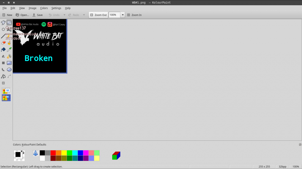

I use kolourpaint to do my minecraft music resource pack record icons.
 Makes doing 12 record icons real easy.
Quazee137
Yea I know its for Linux they also have krita but much more than I need.
