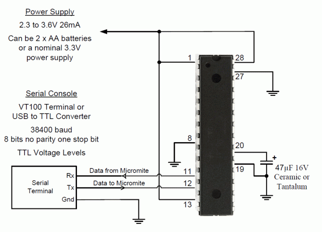

If you want the smallest possible on a breadboard, it will be hard to beat the original MicroMite--if you can find the chip:
The only component you need is the 47uF 16V capacitor (plus your serial connection). Flashing the chip with MMBasic is an issue, though--nothing beats the Picomite for ease of flashing.

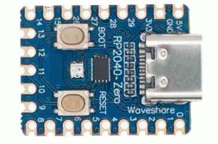

If you want a smaller PicoMite, check out the breadboard-friendly RP2040 module
Posts: 9249
Posted: 02:49pm 05 Sep 2023
That little board (the RP2040 Zero) is great for breadboarding, but only if you want the pins on the two long sides. 9-13 don't work in a breadboard unless you put a separate header on them. Having said that, it's a great little board and is probably cheaper than the Micromite! Board space is actually smaller if you were going to use some sort of regulator, capacitors and some components to connect a Micromite to its console.

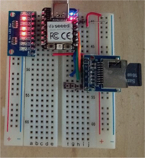

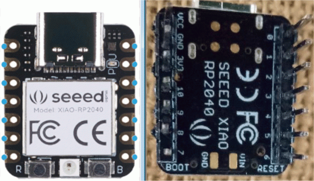

I've done lots of breadboards, but maybe none in the past year or perhaps two. So this was a challenge. The RP2040 mentioned above is superior, but I happened to have a couple of the 14-pin Seeed RP2040 modules.
It was not trivial figuring out the pins from the diagrams and pin numbers on the PCB--they didn't correspond to the Pico pins. After loading MMBasic, I did it by brute force--SETPIN, n,DOUT, then see if I could toggle it.
The right-side pins (top view, USB connector up) are (from the bottom up) 2,4,6,5,3v3,0V,5V; the left side pins are 1,10,9,44,31,32,34.
I used a little SD card module (which apparently some have had trouble with, but I haven't) and these options: OPTION SYSTEM SPI 4,5,6 OPTION SDCARD 2.
I could successfully examine both the A: drive and the B: drive, and save to the B: drive:

I ran this program to randomly turn off and on the LEDs on an 8-LED common anode module (so negative logic--0=on).
Dim integer i,j,k,npins=7,p(6)=(1,10,9,44,31,32,34)
For i=0 To npins-1
 SetPin p(i),dout
 Pin(p(i))=1 ' negative logic for this common anode 8-led module
Next i
Do While 1
 j=Int(Rnd(1)*2) ' 0 or 1
 i=Int(Rnd(1)*npins) ' 0 through npins
 Pause 500
 Pin(p(i))=j

You can't surface mount the Zero, so the resistor and SMD cap are underneath it, The uSD socket is on the back of the board. The assembly is still breadboard friendly if you ignore the fact that GP9 isn't available.
