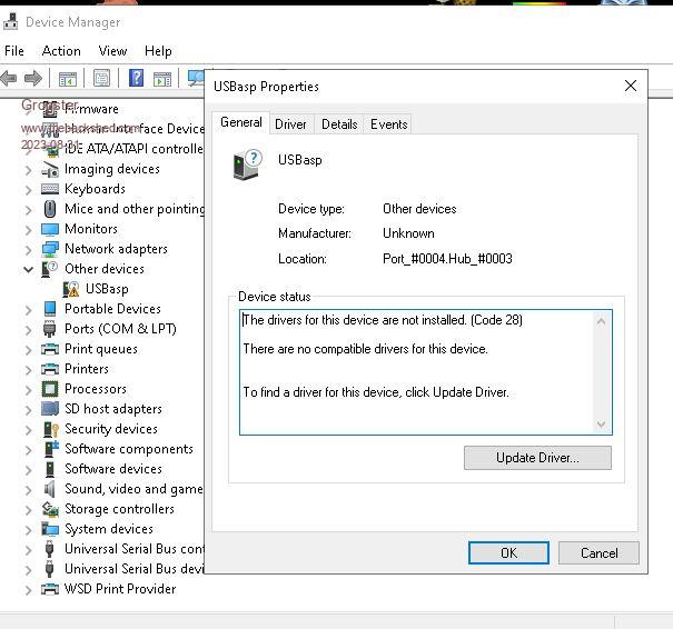

I have just plugged in a USBasb programmer, but Windoze wants drivers for it.
I hoped it would just I.D. as a standard COM port, but aparently not.
Can anyone help me find the drivers I need to make this thing talk?

OK, I have installed the driver, and Windoze seems to be able to see it there:

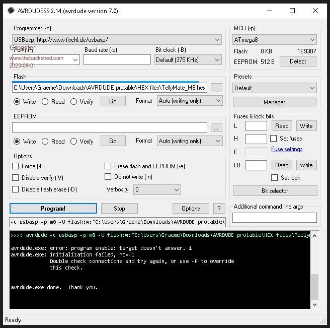

I dropped the bit clock to 187.5kHz, but still no talkie.
I will fit the crystal now, and see if that does it.
I'm just not quite sure what the hell I am doing when it comes to Atmel MCU programming!
EDIT: Added a 16MHz crystal across pins 9 & 10, with 22pF caps to GND, but the MCU is still undetected.
I must be doing something fundamentally wrong, but I can't currently see what that is.
Thought it would spring to life once I added the crystal and caps....

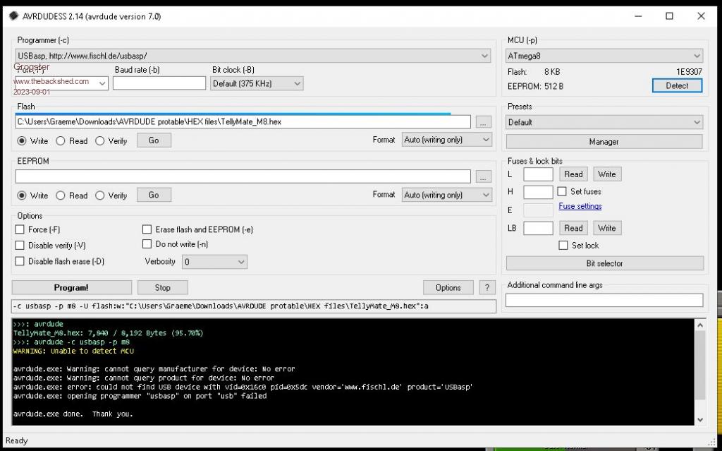

Here is the output, when I click on DETECT:
Posts: 6631
Posted: 07:22am 01 Sep 2023
third line
could not find USBasp.
You need that bit fixed before you worry about the MEGA8

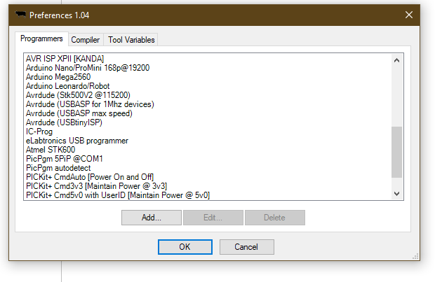

Doubt if relevant but Great Cow Basic programmer supports USBAS

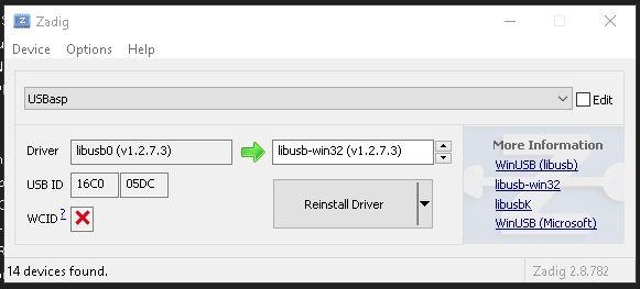

On windows use must use ZADIG and must choose the correct driver - you want libusb-win32. This is not the default - use the dropdown. Suggest you uninstall zadig and start again
Posted: 12:01am 02 Sep 2023
@ JIM - VID & PID match.
@ matherp - I did follow the ZADIG program, and did select the win32 driver INITALLY, but when I rerun ZADIG, it says it is trying to use libusb0 driver, so I have selected libusb-win32, and will try again.

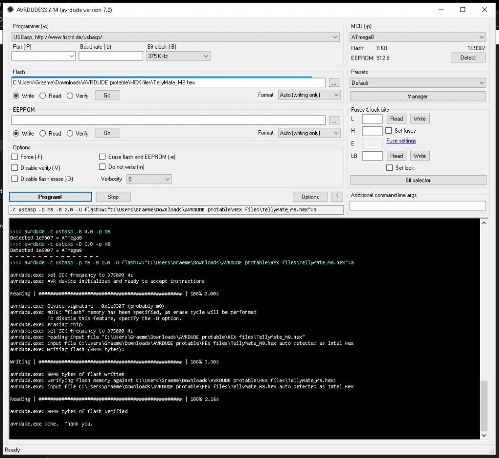

Posted: 12:22am 02 Sep 2023
Owwwww - "Detected 1e9307 = Atmega8"....
Lets see if I can program it....
YAY!!!
...and I have discovered that you DO have to have the 16MHz osc in place for the chip to even be detectable at all.  Just tried to do a 2nd mega8 chip without the osc, and no talkie.  Put the crystal and two caps back again, and talkie talkie talkie!
But progress!
I will now program the remaining four chips and store them labelled as programmed with the TellyMate firmware.
