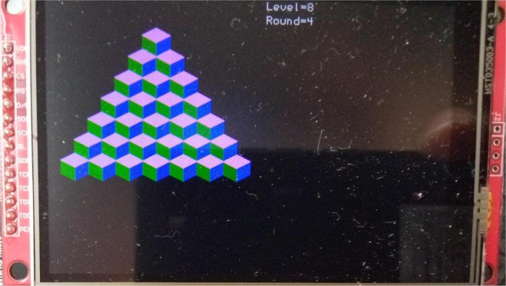

Running on standard PicoMite with 480x320 ILI9488 LCD after replacing "SPRITE" with "BLIT".
Commenting out the first line, "MODE 2" it ran to line 114:  blit show 2-(of%=7), x%, qy%-sw%(of%), 2,1
I commented that out and it ran to Level 8, Round 4, flashing many colors in a triangle of apparent cubes of which you can see three sides (which appear to be the same shape in different orientations).
It crashed at line 59, Blit write n,x+160,y,1
This is what a screen shot looks like after the crash:
I commented out line 59 and then it runs to the same point, Level 8, Round 4, and then, after a pause, it repeats.
(I have no idea what might happen if those lines were not commented out, and know nothing about the game.)

  lizby said  Running on standard PicoMite with 480x320 ILI9488 LCD after replacing "SPRITE" with "BLIT".
That's the difference between Sprite and Blit
Sprite write n,x+160,y,1 works on Picomite VGA, the ",1" tells the Pico to show the Sprite mirrored. Sadly this option doesn't work with Blit.. So you can delete the last parameter, but the Sprites are always facing left.
Of course, you can also create them in both directions,
something like
Restore qb1
For n=1 To 26
Read wx,wy
For y=0 To wy-1
Read sp$:sp$=expand$(sp$)
 For x=0 To wx-1
    Pixel x,y,cl%(Val("&H"+Mid$(sp$,x+1,1)))
    Pixel (2*wx)-x,y,cl%(Val("&H"+Mid$(sp$,x+1,1)))
 Next x
Next y
Next n
That doubles the number of Sprites and you will run out of possible Sprites,
So for the game you leave most of the sprites untouched, but Bert and Coily have to be mirrored (for the movement right up and right down) and that would be 8 additional sprites.

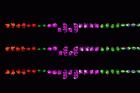

On a picomite with ILI9488 480x320 LCD, here's a screen shot of the sprites in normal orientation and flipped with Peter's new code for BLIT WRITE which allows mirroring:
After the sprites are read in and built:
For n=1 To 26: Blit write n,n*18,80: Blit write n,n*18,160,1: Blit write n,n*18,240,2:Next
That's how they're supposed to look.
Unfortunately I can't get my "LCD Pico" to display anything at the moment. I will test it. But that all has to wait, from Tuesday I'll be in the Netherlands for 8 days. My first vacation after 5 years..

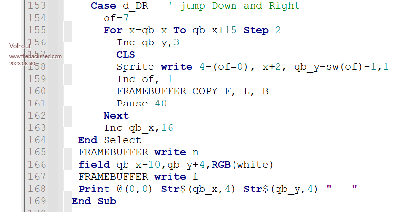

Nice...very smooth moves...
You did not color the top tiles yet...
Insert lines 165..167

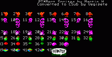

Here's a short program with the sprites converted to CSub form, as used by Picomite(VGA) firmware 5.0708b16 (or newer.) This just displays them on screen. I've created the various required mirror images - Ugg and Wrongway were a bit tricky because they actually need to be mirrored at 45 degrees. Next I need to compress them...

  vegipete said  Here's a short program with the sprites converted to CSub form, as used by Picomite(VGA) firmware 5.0708b16 (or newer.) This just displays them on screen. I've created the various required mirror images - Ugg and Wrongway were a bit tricky because they actually need to be mirrored at 45 degrees. Next I need to compress them...
good work,
Ugg and Wrongway have to be, the way they are ..:-)
Because in the Game, they use a twisted perspective (Sides as top), they are displayed as they are.
Mart!n

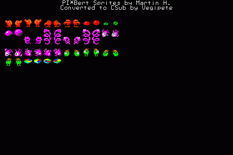

That's what it looks like on a PicoMite with ILI9488 with this code:
'autosave
Option DEFAULT INTEGER
If MM.Device$="PicoMiteVGA" Then
 MODE 2
Else
 FRAMEBUFFER create
 FRAMEBUFFER write F
Dim glof(50)
Restore GlyphOff
Read n : glof(0) = n
For i = 1 To n:Read glof(i):Next
CLS
Text MM.HRes/2,0,"PI*Bert Sprites by Martin H.","CT"
Text MM.HRes/2,10,"Converted to CSub by Vegipete","CT"
spad=Peek(cfunaddr Glyphs)
x = 10 : y = 40
For i = 1 To glof(0)
 Blit memory spad+glof(i),x,y
 Inc x,20
 If i = 12 Then x = 10 : Inc y, 20
 If i = 24 Then x = 10 : Inc y, 40
 If i = 36 Then x = 10 : Inc y, 20
Next i
If MM.Device$="PicoMite" Then FRAMEBUFFER copy f,n
End
I don't know if the blank sprites are supposed to be blank.
Edited 2023-09-18 21:44 by lizby
Posts: 6199
Posted: 12:05pm 18 Sep 2023
Hi lizby,
Your image is okay.
There are no blank sprites. Some are vertically larger....
Posted: 12:19pm 18 Sep 2023
  Volhout said  Some are vertically larger....
Ah, got it. Thanks.
