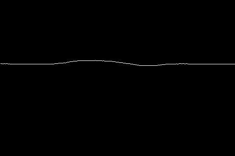

Posted: 02:50pm 17 Aug 2023
This is what I seen running on a PicoMite with 480x320 ILI9488:
What would I do to see something more interesting?
amigawizard
Joined: 15/08/2023
Posts: 43
Posted: 03:15pm 17 Aug 2023
@ Lizby
  pixel x , -(anaray2(x+t)*90)+150)
     and connect  pin1  to pin32
     *90  set the  gain
     F2  rerun   !

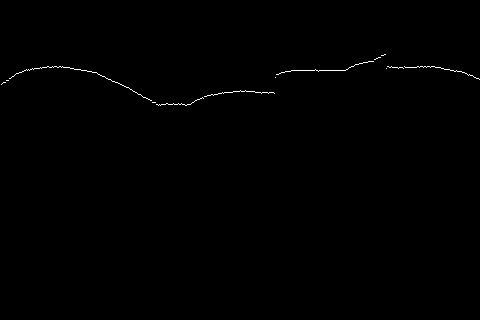

Posted: 03:32pm 17 Aug 2023
Ok, thanks. With that, I get this:
amigawizard
Joined: 15/08/2023
Posts: 43
Posted: 04:15pm 17 Aug 2023
@ lizby
      pixel x , -(anaray2(x+t)*gain)+offset)
      pixel x , -(anaray2(x5 +t)*90)+150)
 try     For x = 1 To 480
     Wayne  !!!!
