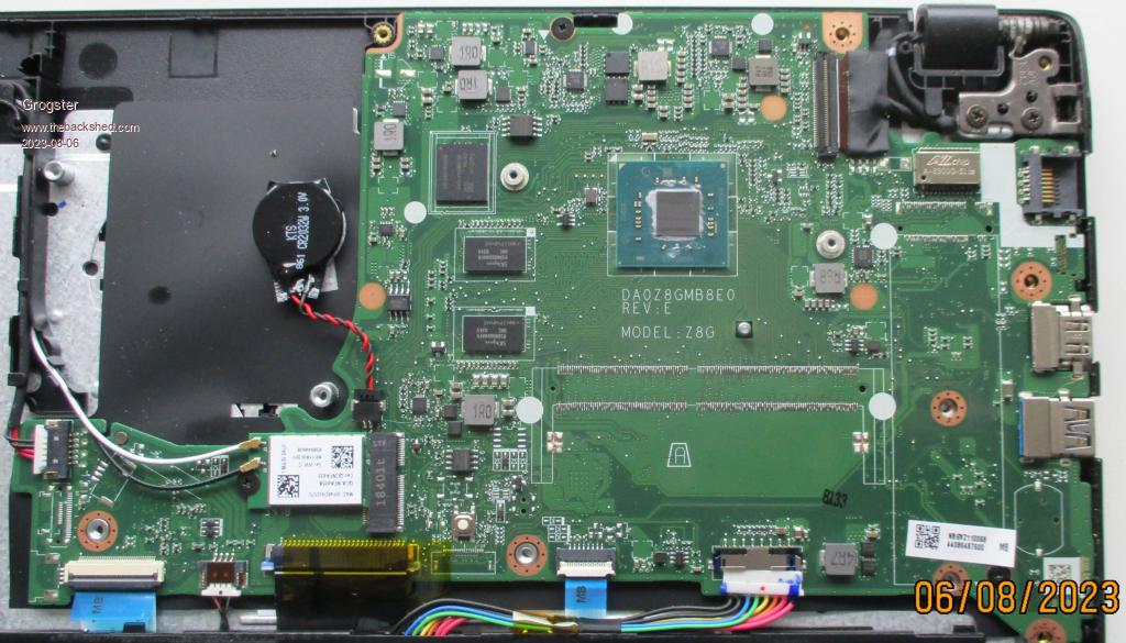

COMPLAINT: "Screen says 'No bootable device detected.'"
OK, I assumed that perhaps dead spinning HDD or SSD, or perhaps even dead M.2 SSD.
Crack open laptop.
Memory AND SSD integrated into the motherboard, you CANNOT remove or upgrade either.
CPU in the center, 2x RAM chips lower-left, SanDisk 64GB SSD to the slightly upper-left of the CPU.
Note that there ARE footprints for both standard SODIMM modules AND M.2 SSD devices - but they are not populated, so you're kinda screwed once the SanDisk SSD chip refuses to be detected by the BIOS on this machine.
Could be a candidate for Linux on a USB stick, but when I suggested that, the client said: "What's Linux?"
...they know nothing other then Windoze.

Typical "you get what you pay for" construction. I have a couple of fanless mini desktop machines that are similar - soldered in storage & CPU. You have to regard these things as disposable items really because the storage has a limited life. Not really worth fixing as the spec is getting too low to be really useful now.

A VERY longshot, but... I have had a couple of laptops that would not go beyond the BIOS whilst the RTC battery was dead.  Replacement of the dead 3V lithium cell brought them fully back to life.  Given the heavy-handed minimal cost approach to the motherboard, it might be that they are also getting cheapskate on the lithium cell.  Worth a check before the dustbin.
Just for info, what is the brand/model of the laptop?
Edited 2023-08-06 23:06 by circuit
Posted: 02:32pm 06 Aug 2023
  circuit said  A VERY longshot, but... I have had a couple of laptops that would not go beyond the BIOS whilst the RTC battery was dead.  Replacement of the dead 3V lithium cell brought them fully back to life.  Given the heavy-handed minimal cost approach to the motherboard, it might be that they are also getting cheapskate on the lithium cell.  Worth a check before the dustbin.
Me to. Mine was 2.8V. A "new" one was 3.3V. It boots ok now,win 10 pc

Is it just me or dose it look like someone removed the SODIM RAM sockets quite badly and could you just get some sockets and solder them on and upgrade the thing?

Is that an Acer laptop?
Posted: 12:20am 07 Aug 2023
Yes, Acer Aspire 1 A114-32 series.
Model # N17Q4
I will try another CMOS battery - worth a try, I have it open now anyway.
You never know!
EDIT: Old battery still tests as 3.1v for a 3v cell, so I am pretty sure that is OK, so I have left it where it is.  Mr. Google shows me some replacement mainboards can be had for this machine, but they are 2nd hand, so I won't be going down that path, cos they could simply die like this one has at any moment.  Have not found any new ones yet, and I don't really expect to.  They were probably mass-produced at the time as a one-off production run, and once all the boards were gone, then all the boards are gone(new ones, I mean).

You could try reheating the SSD in case one of the BGA balls was dry jointed, If you are going to scrap it anyway.

i see there is some sort of wireless card in there. you could look at replacing that with an M2 card (or whatever fits in the slot) then plug in an external wifi dongle for the wireless side of things.
looks like it has 4gb of RAM, so would make a nice little linux machine. if the touchpad is dodgy, disconnect it - it may even be connected via USB, so you could wire in a wifi dongle there. is there much free space inside the case?

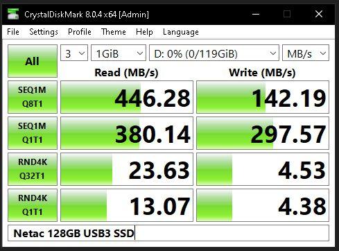

However, I have found a "Real" 128GB SSD in USB3 format for about thirty bucks, so I am going to get one of these and play with BOTH Mint and also Windows using this machine's single USB3 port.
USB3 SSD....
As this is an SSD and not a flash-drive, I am hoping for a good performance boost.
Worth a try for thirty bucks anyway!
Oh, and Quazee137 - thanks for the offer of $$, but I would not impose or suggest the members help with cash.  Sorry if it read that way.  NOT intended.  He can't afford a a NEW laptop, but I can come up with something I think that will still be within his budget - such as a $30 SSD, and I give my setup time for free.
But thanks.
Posted: 06:53am 11 Aug 2023
UPDATE: Mint runs very well indeed from the USB3 SSD.  It's almost as fast on boot-up/shutdown, as a standard install.
The USB3 SSD is quite impressive:
Sequential read and write are very good indeed for a USB flash-drive form-factor.
The random read and write are not so good, but we're only talking thirty bucks here...
Still, the fast sequential read/write does result in Mint booting up and running the primary app - firefox browser - very quickly indeed.
Results would be even better I guess, with a "Proper" USB3 external SSD, but possibly not by that much as far as your average user is concerned.
