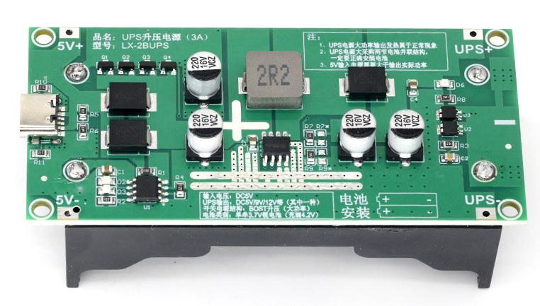

I recently discovered on Aliexpress an 18650x2 UPS module that may be quite useful to some out there.
The module is L/W/H 89mm(3.5") x 42mm(1.65") x 24mm (0.95") in size and has a USB-C input for charging of the 2 x 18650 cells and outputs a constant 5V to your device. They also have 9V out and 15V out types (select the option you need) however I am fairly certain it is a simple resistor (SMD 0805 type) change that selects the desired output voltage. I bought a 5V type and have ordered 2 more to play with.
The seller I bought my unit off also had a single 18650 cell type but I didn't buy one of them to play with.
The Price? Under $5AU inc shipping to Australia, No 18650 batteries of course.

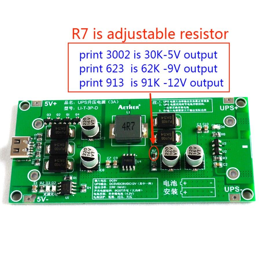

It looks like R7 / R9 might be a potential divider for the feedback signal, so they may be setting the output voltage. Bit of a fiddly area to get to.

Wasn't a bad guess. :)

I had previously looked up the specs of the DC-DC converter chip  and saw the resistor R7 to change for different output voltages and it matched my value exactly.

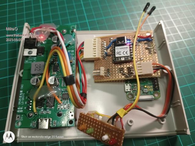

Some time ago I wrote code (picomite) to control the power supply and UPS running a Raspberry pi server. I used similar to these , I monitor the 12v supply into the ups so that I can react to a power fail closing down the pi after a period of time, also issue shutdown signal on the network(NUT) to close a Synology NAS. The UPS I used were a bit pricey but all I could find at the time, I have ordered some of these UPS in this thread and will try with these also.
