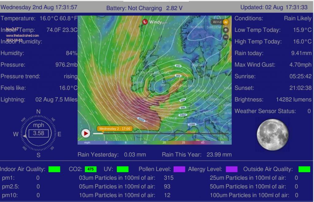

I have this problem
Indoor Humidity only flashes on the screen the goes off again
I know the sensor is working as the CO2 data is displaying

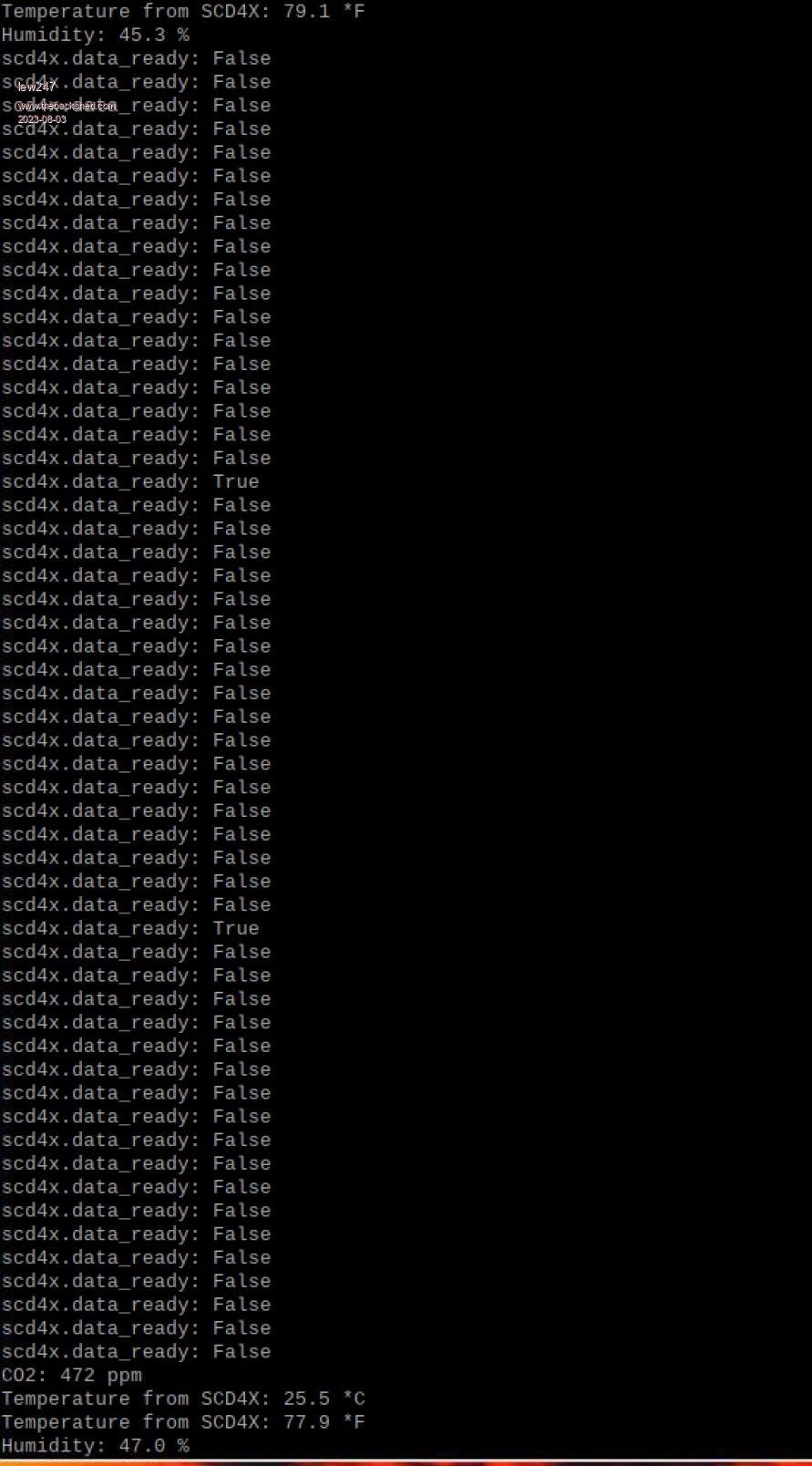

Here is the console output showing the result of print("scd4x.data_ready:", scd4x.data_ready)
How do I get the data to display on the screen but ignore the False, unless there is over 60 seconds of False then it might be a sensor issue
Basically I need a trigger to display the data when the data is true, start a timer ignore any False >= 60 seconds
If any True then the timer restarts
I have spent a total of maybe 18 hours now trying different ways of doing this and even ChatGpt can't help with this because it tried to get me to use a "While True" loop which locks the Pi up
I can't use While True
any suggestions?
