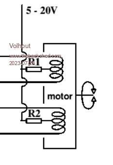

Hi Pascal,
Your code uses an ASCII (text) pattern that is convertoed to logic bits at each step of the motor. That is consuming CPU, so it will slow down the motor maximum speed.
As mick said: store the bit pattern as a nibble (4 bits) in an integer array.
dim pattern%(3)=(&b0110,&b0101,&b1001,&b1010)
And then
  FOR STP=0 TO 3               'CW rotation
    PORT(GP15,4)=pattern%(STP)
    PAUSE 5                    'increase PAUSE value to SLOW rotation.
  NEXT STP
You ask about many steps per rotation: the position of the rotor axis is depending on the position of the rotor between the magnetic poles. When you drive the poles ON/OFF then you have only few steps. But if you drive them 100%/50%/0% you get more steps. And if you increase this to 100%/80%/60%/40%/20%/0, you can imagine there are many more rotor positions possible. They call these steps "microsteps". And a smart control of each pole pair can guarantee constant torque in each of these "micro-positions". i.e. you get the same rotor position when 1 coils is 20% the other is 40%, as when 30%/60% or 40%/80% or 50%/100%. But in each of these cases, the torque that the motor can deliver is different.
In many modern stepper driver the current through the coil is controlled from a PWM system with feedback (measuring the actual current).
Edited 2023-07-27 20:43 by Volhout

Posts: 6200
Posted: 01:08pm 27 Jul 2023
Pascal has stepper motors that have centre tapped coils (6 wires, 3 for each coil).
The centre pins go to +5V, you connect the other 2 alternating to ground.
His "driver"is a ULN2003 that can do this. The ULN2003 has no intelligence.
So his software has to do everything. Drive each individual pin (generate the phase rotation signals), control the frequency of that rotation.
Most of that is done in hardware in more modern chips.
P.S. Pascal, your motors have something like 64 steps per rotation, but have a gear box attached. That is why on the outgoing axis it may look like 4000 steps per rotation.
Edited 2023-07-27 23:09 by Volhout

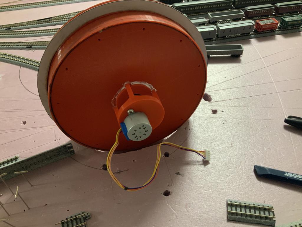

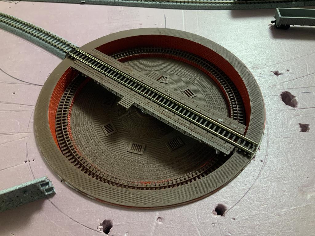

Hi Palcal
I use this type of stepper on my N scale train turntable. I have supplied code for it, but it is not optimized and not the final code that I will use as I was simply using it to test the turntable.
The final code will be modified to run on a Pico W instead of the Pico that I use now.
BTW, this code works with Ver 5.07.07 , enjoy!

Hans ...
PS: I do use an ULN2003 driver board with it (as your link shows) and power it with a separate 5 volt supply to the board.

I don't pretend to know how this works entirely, however it is what I gleaned from this web site when I was researching the 28BYJ-48;
28BYJ-48
Please correct me if I have not understood the concept. I really am a noob when it comes to integration of electronics and code. I have seen a lot of smart code and designs on this site from you guys. Everyday I come to this site I learn something new.
Hans ...

I would never say no to extra code!
I see the steppers you are using are the typical type that are used on 3D printers?
I showed the water gadget to my wife and I think I have another project now.
Never thought to use a driver board from Arduino, what board is that exactly?
Thanks for the post Dave
Hans ...

A number of those bit patterns have 3 bits set. Are you sure that is what you want?
For this motor patterns with both coils in one direction active will only heat up the motor.
Hans

Thanks, now I understand what you guys were getting at.
Yes I was wondering why the stepper was running warm but it's not hot. I thought it was normal running not having driven one of these before.
My mistake from the web site was I assumed the 1's in the chart represented an on state.
My new code uses;
Sub bmotion
 step8$ ="1000"
 step7$ ="1100"
 step6$ ="0100"
 step5$ ="0110"
 step4$ ="0010"
 step3$ ="0011"
 step2$ ="0001"
 step1$ ="1001"
Thanks guys it runs perfectly cool now!
