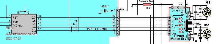

I have used the LM298N to control motors on a robot car using a picaxe.
connecting the EN inputs to the PWM output enables speed control.
By using a loop in the program to increase the PWM output you can simulate soft start of the motors.

Bill's circuit is identical to your setup (as I read from post #1).
He uses a single PWM, and independent GPIO lines for the direction of the motor.
Grogsters program uses the one PWM for direction forward (or left), and the other for direction backward (or right). He uses a different motor driver chip, or he connects both PWM's to the 2 direction pins on the L298, and keeps the enable static active.

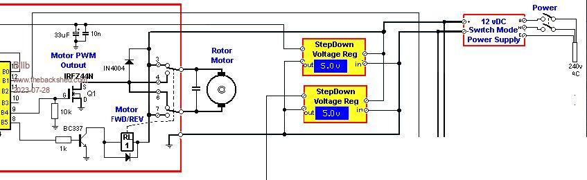

The L298 is very inefficient and loves converting your available power into heat because it has a high voltage drop (2-3V at 1A). If the motor will never have its direction changed unless it's stopped then the best way to get a direction change is with a suitable DPCO relay, then a simple mosfet driver from PWM will be fine for the speed. Everything will run cool and efficiently. When you want to change direction, ramp the speed down to zero and flip the relay over then ramp up again. If you don't do it this way then you could destroy the mosfet.
If you use separate forward and reverse SPCO relays then you can arrange them such that the motor is short-circuited with power off (or both relays energised). This gives a rapid stop, which can be very useful.

As Mick suggested,  If motor direction is required use a relay and a Mosfet to power the motor.
