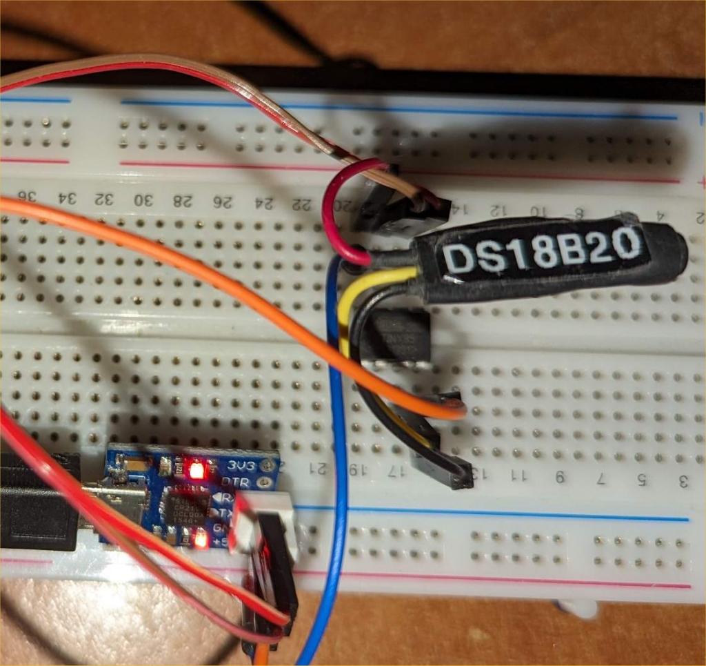

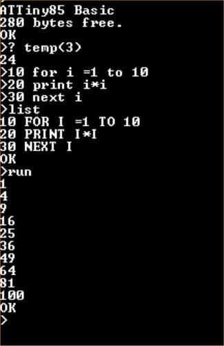

TinyBasic on the ATTiny85
including digital read/write, analog read/write, DS18B20 support and tones.
Program can be save in the in-built EEPROM and run on power-up
All implemented in  8K flash and 512 bytes of RAM and EEPROM

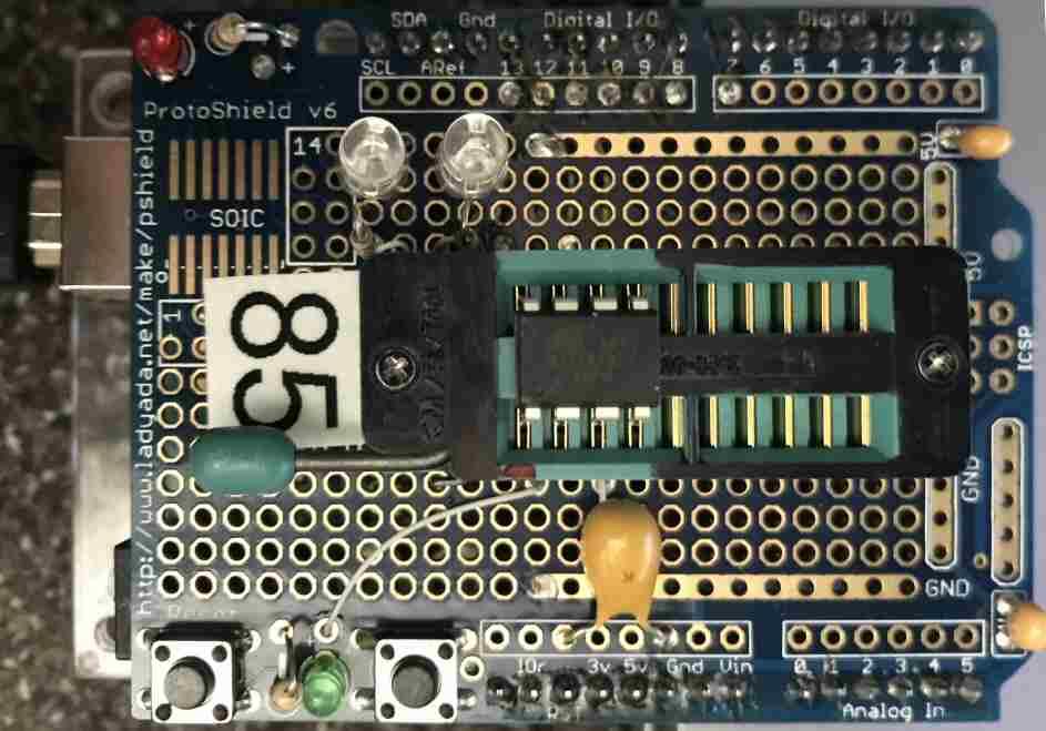

I've got my Uno and ATTiny85 Arduino programming shield sitting right here. I suspect, however, that's not the way you're going to have us do this :-)

You all must be aware , .and have forgotten about it.
But Tinybasic is , TINY.
Only 26 integer variables (16 bit) and no strings.
And with 280 bytes free your programs are small.
I have tinybasic on UNO, with 900 bytes RAM and even then, it is a challenge.
It will just hold the 4 squares program.
Nice for a programming Challenge through, and as a statement that it can be done.
PICAXE 08M2 is in a different league.
Peter: you can use program memory better if you allow to abbreviate commands ( they are stored in ascii). In the command parser, add 2 lines that allows to use the abbreviation with a ".". So PRINT becomes P. and DREAD becomes DR. The dot alse is terminator, so you can skip the trailin whitespace.

Eeeeh.... I remember Li Chen Wang's Palo Alto Tiny BASIC! :)  It was the first BASIC I ever used. Well, a version of it anyway.
10 F.I-1TO10
20 P.I*I
30 N.I
Might have been how I'd have written it at the time. Every byte was precious so there were no spaces or comments unless you *really* needed them. :)
I wonder if this supports the (one and only) array @() which is automatically dimensioned to use all the spare memory?
