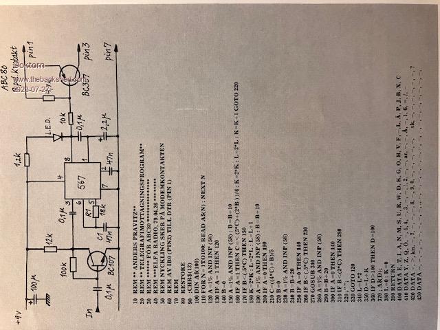

Hi RicM
This is from Swedish Computer Magazine MikroDatorn
November 1979.

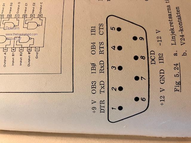

The port is not a true V24, it is port B on a Z80-PIO.
Written for Swedish computer ABC80.
Have fun.
/Lasse
