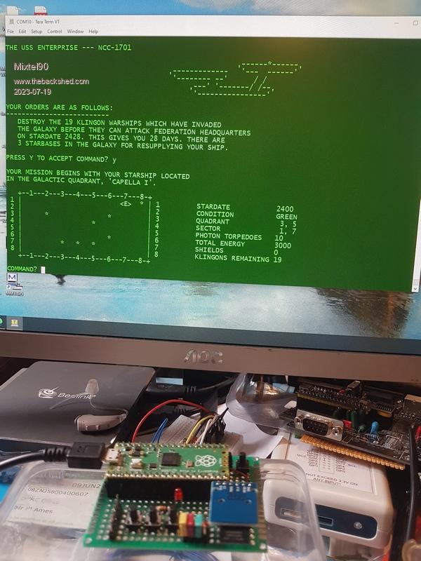

I found an RC2014 emulator for the Pico Here and couldn't resist. One of my PicoMites went over to the Dark Side and is now running Stephen Cousin's Small Computer Monitor and CP/M 2.2 with the aid of a microSD card. At the moment I'm using Tera Term to talk to it, but that's because it's easy and I haven't wired up the serial port yet. :) Maybe a photo in a bit, it's playtime.
The microSD card uses files to emulate floppy drives A to P.
You get the joys of running Grant Searle's adaptation of the old Nascom version of Microsoft BASIC from ROM or MBASIC (1977-1981 version) under CP/M - all with line numbery goodness!
Set Tera Term up for ancient green screen to get the true flavour. :)

The one I was running on the RC2040 (which is a RC2014 emulator running on a Pico) was provided on drive D: of the microSD card files. Either I'm not waiting long enough or there's a bug when you use the COM command.
The version I've been working from for conversion to MMBasic is Here but with additional assistance from the David Ahl book.

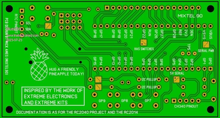

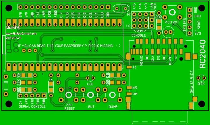

Would anyone like a PCB design for this little board? I could do one with a standard size SDcard socket to make soldering easier.
