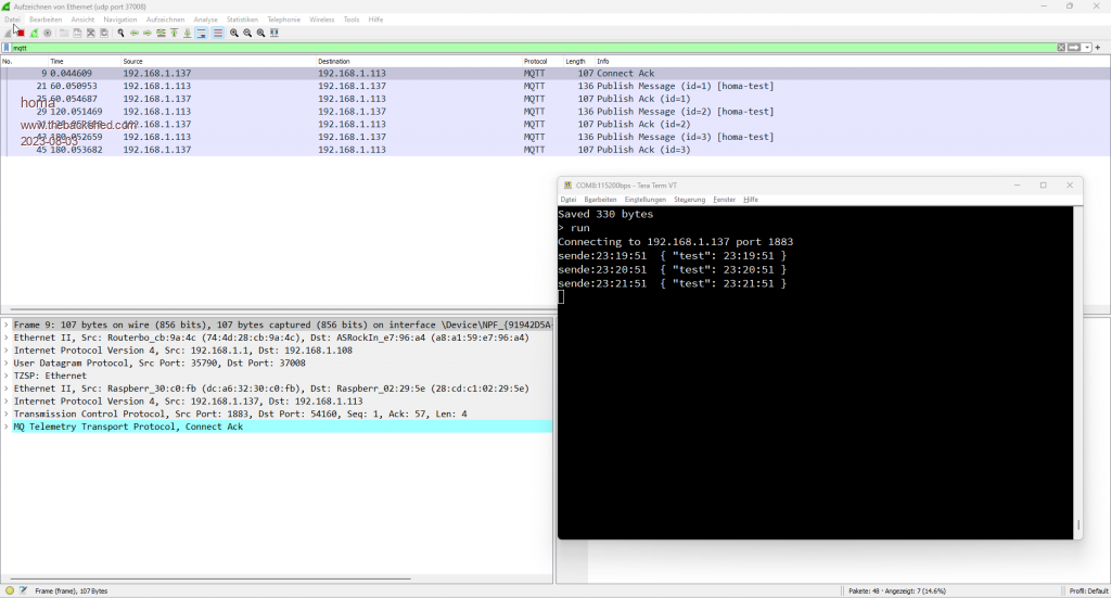

Unfortunately I don't see this in Wireshark!
My little test programme:
WEB mqtt close
WEB mqtt connect "192.168.1.137", 1883, "mqtt", "*******"
SetTick 60000,mymqtt
Dim test$
Sub mymqtt
test$=Time$
Print "sende:";test$,
value$="{ "+Chr$(34)+"test"+Chr$(34)+": "+test$+" }"
WEB mqtt publish "homa-test",value$
Print value$

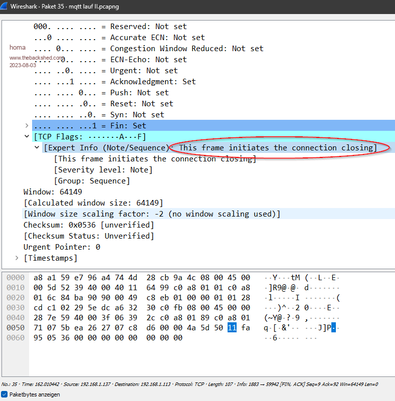

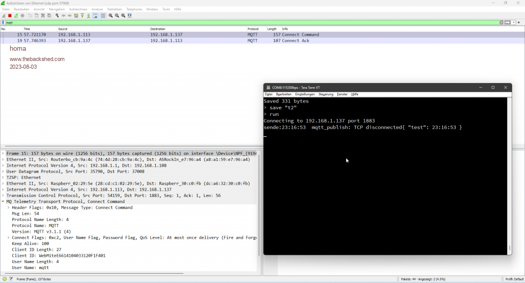

At 60 seconds, everything looks good ...
I don't see a keep-alive signal after 180 seconds ... Instead, the system tells me that the connection has been closed.
Edited 2023-08-03 07:41 by homa
Posts: 12074
Posted: 07:27am 03 Aug 2023
  Quote  I don't see a keep-alive signal after 180 seconds .
You haven't had 100 seconds of inactivity so won't see a keep-alive
homa
Joined: 05/11/2021
Posts: 728
Posted: 07:50am 03 Aug 2023
Certainly. I changed the SetTick beforehand for the 180 seconds
I also get an error message. How can I record this in the programme? At the latest then I can react with a "close/open" and the message is sent. And received by the broker.
homa
Joined: 05/11/2021
Posts: 728
Posted: 08:58am 03 Aug 2023
Hi Peter,
I have now recorded a complete test run without the MQTT filter.
It seems that the Keep-Alive is not recognised as an MQTT protocol by Wireshark, but only as a TCP protocol.
So you are right!
But this must be faulty
, because shortly afterwards the MQTT message comes out of the programme (10:42:52)! But this is rejected by the broker server.
The close/open helps in the running programme, as you can then see.
Matthias

I have reduced the test program again.
1) connect to MQTT server
2) after 10 seconds a MQTT message
3) wait! and after about 150 seconds the PINGREQ/PINGRESP TCP messages? *
4) after another 10 seconds the next MQTT message. But instead the message "mqtt_publish: TCP disconnected" AND no TCP messages in WireShark!!!!
Maybe the bug is that a status is set incorrectly in MMbasic and the interpreter does not realise that it is still allowed to send? Where else would the error message come from?
Can you please check this in the source code? Thanks a lot!
Matthias
*Addendum:
I just see that after the 150 seconds the connection from the server (192.168.1.137) to the client (.113) is established! Is it possible that this is the disconnect message? (YES! see screenshot.) Then PINGREQ/PINGRESP would definitely be missing in beta10.
(1)
1 0.000000 192.168.1.113 192.168.1.137 TCP 101 59941 → 1883 [FIN, ACK] Seq=1 Ack=1 Win=16376 Len=0
2 0.000000 192.168.1.113 192.168.1.137 TCP 101 [TCP Retransmission] 59941 → 1883 [FIN, ACK] Seq=1 Ack=1 Win=16376 Len=0
3 0.000618 192.168.1.137 192.168.1.113 TCP 107 1883 → 59941 [FIN, ACK] Seq=1 Ack=2 Win=64148 Len=0
4 0.000748 192.168.1.137 192.168.1.113 TCP 107 [TCP Retransmission] 1883 → 59941 [FIN, ACK] Seq=1 Ack=2 Win=64148 Len=0
5 0.002740 192.168.1.113 192.168.1.137 TCP 105 59942 → 1883 [SYN] Seq=0 Win=16384 Len=0 MSS=1460
6 0.003069 192.168.1.113 192.168.1.137 TCP 105 [TCP Retransmission] 59942 → 1883 [SYN] Seq=0 Win=16384 Len=0 MSS=1460
7 0.003293 192.168.1.137 192.168.1.113 TCP 107 1883 → 59942 [SYN, ACK] Seq=0 Ack=1 Win=64240 Len=0 MSS=1460
8 0.003440 192.168.1.137 192.168.1.113 TCP 107 [TCP Retransmission] 1883 → 59942 [SYN, ACK] Seq=0 Ack=1 Win=64240 Len=0 MSS=1460
9 0.009186 192.168.1.113 192.168.1.137 TCP 101 59941 → 1883 [ACK] Seq=2 Ack=2 Win=16375 Len=0
10 0.009546 192.168.1.113 192.168.1.137 TCP 101 [TCP Dup ACK 9#1] 59941 → 1883 [ACK] Seq=2 Ack=2 Win=16375 Len=0
11 0.009935 192.168.1.113 192.168.1.137 MQTT 157 Connect Command
12 0.010139 192.168.1.113 192.168.1.137 TCP 157 [TCP Retransmission] 59942 → 1883 [PSH, ACK] Seq=1 Ack=1 Win=16384 Len=56
13 0.010310 192.168.1.137 192.168.1.113 TCP 107 1883 → 59942 [ACK] Seq=1 Ack=57 Win=64184 Len=0
14 0.010439 192.168.1.137 192.168.1.113 TCP 107 [TCP Dup ACK 13#1] 1883 → 59942 [ACK] Seq=1 Ack=57 Win=64184 Len=0
15 0.010960 192.168.1.137 192.168.1.113 MQTT 107 Connect Ack
16 0.011126 192.168.1.137 192.168.1.113 TCP 107 [TCP Retransmission] 1883 → 59942 [PSH, ACK] Seq=1 Ack=57 Win=64184 Len=4
17 0.237845 192.168.1.137 192.168.1.113 TCP 107 [TCP Retransmission] 1883 → 59942 [PSH, ACK] Seq=1 Ack=57 Win=64184 Len=4
18 0.237845 192.168.1.137 192.168.1.113 TCP 107 [TCP Retransmission] 1883 → 59942 [PSH, ACK] Seq=1 Ack=57 Win=64184 Len=4
19 0.239745 192.168.1.113 192.168.1.137 TCP 101 59942 → 1883 [ACK] Seq=57 Ack=5 Win=16380 Len=0
20 0.239745 192.168.1.113 192.168.1.137 TCP 101 [TCP Dup ACK 19#1] 59942 → 1883 [ACK] Seq=57 Ack=5 Win=16380 Len=0
(2)
21 10.016971 192.168.1.113 192.168.1.137 MQTT 136 Publish Message (id=1) [homa-test]
22 10.017126 192.168.1.113 192.168.1.137 TCP 136 [TCP Retransmission] 59942 → 1883 [PSH, ACK] Seq=57 Ack=5 Win=16380 Len=35
23 10.020780 192.168.1.137 192.168.1.113 MQTT 107 Publish Ack (id=1)
24 10.020944 192.168.1.137 192.168.1.113 TCP 107 [TCP Retransmission] 1883 → 59942 [PSH, ACK] Seq=5 Ack=92 Win=64149 Len=4
25 10.258225 192.168.1.113 192.168.1.137 TCP 101 59942 → 1883 [ACK] Seq=92 Ack=9 Win=16376 Len=0
26 10.258369 192.168.1.113 192.168.1.137 TCP 101 [TCP Dup ACK 25#1] 59942 → 1883 [ACK] Seq=92 Ack=9 Win=16376 Len=0
(3)
35 162.010442 192.168.1.137 192.168.1.113 TCP 107 1883 → 59942 [FIN, ACK] Seq=9 Ack=92 Win=64149 Len=0
36 162.010644 192.168.1.137 192.168.1.113 TCP 107 [TCP Retransmission] 1883 → 59942 [FIN, ACK] Seq=9 Ack=92 Win=64149 Len=0
37 162.012541 192.168.1.113 192.168.1.137 TCP 101 59942 → 1883 [FIN, ACK] Seq=92 Ack=10 Win=16375 Len=0
38 162.012616 192.168.1.113 192.168.1.137 TCP 101 [TCP Retransmission] 59942 → 1883 [FIN, ACK] Seq=92 Ack=10 Win=16375 Len=0
39 162.012839 192.168.1.137 192.168.1.113 TCP 107 1883 → 59942 [ACK] Seq=10 Ack=93 Win=64148 Len=0
40 162.013073 192.168.1.137 192.168.1.113 TCP 107 [TCP Dup ACK 39#1] 1883 → 59942 [ACK] Seq=10 Ack=93 Win=64148 Len=0
(4)     ???
> run
Connecting to 192.168.1.137 port 1883               <== (1)
sende:12:47:49  { "test": 12:47:49 }                <== (2)
..........................................................................................<== (3) ......
sende:12:51:39  mqtt_publish: TCP disconnected{ "test": 12:51:39 }    <== (4 - nothing!)
