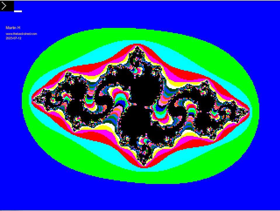

Even with just 16 Colors you are able to draw colorfull pictures with small Code
'MMBASIC (PicoMiteVGA) translated from Qbasic Source:
'https://rosettacode.org/wiki/Julia_set#QBasic
escala = 1 / 81:zeroX = 160:zeroY = 120
maxiter = 32
CR = -.798
CI = .1618
dim integer CL(15)
Restore COLORS:for y=1 to 15:read CL(y):next
mode 2
FOR x = 0 TO 2 * zeroX - 1
   FOR y = 0 TO 2 * zeroY - 1
       zreal = (x - zeroX) * escala
       zimag = (zeroY - y) * escala
       FOR iter = 1 TO maxiter
           BR = CR + zreal * zreal - zimag * zimag
           zimag = CI + 2 * zreal * zimag
           zreal = BR
           IF zreal * zreal + zimag * zimag > 4 THEN
               Pixel x, y, cl((iter MOD 16))
               EXIT FOR
           END IF
       NEXT
   NEXT
NEXT
END
colors:
'--Colorscheme accordung to matherp
Data RGB(BLUE),RGB(GREEN),RGB(CYAN),RGB(RED)
Data RGB(MAGENTA),RGB(YELLOW),RGB(WHITE),RGB(MYRTLE)
Data RGB(COBALT) ,RGB(MIDGREEN),RGB(CERULEAN),RGB(RUST)
Data RGB(FUCHSIA),RGB(BROWN),RGB(LILAC)
'no comment
