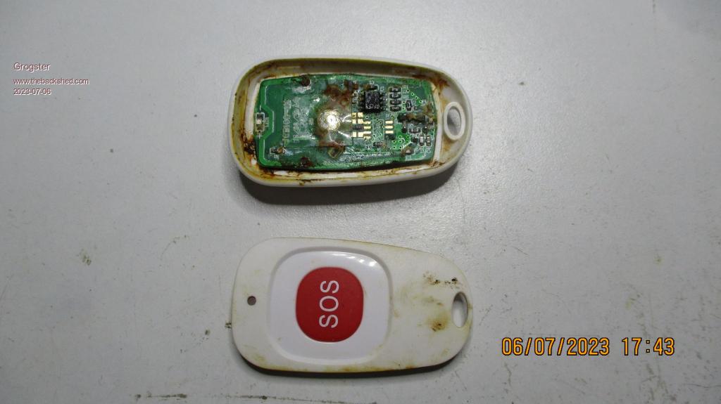

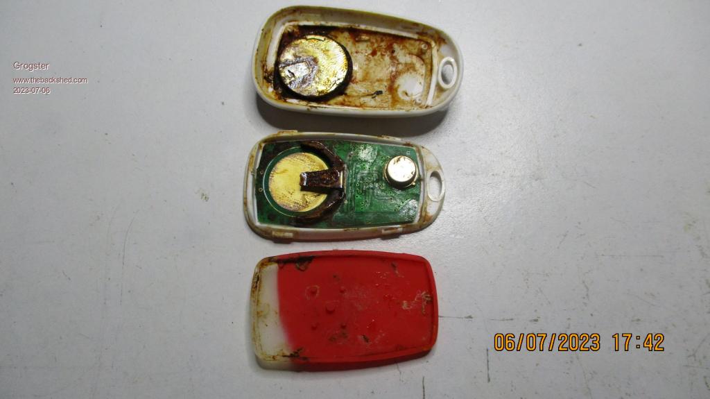

One of the residents at the local retirement village, wore their SOS pendant in the salted pool.  The pendants are not submersible rated, so water got in there, and the Lithium batteries did not exactly like that...

I was actually quite impressed with this. (the destroyed SOS pendant)
I expect that once the salt-water breached the pendant internals, the salty water provided a circuit to short out the Lithium cells, but I was most impressed that this happened after just ONE swim.
The pool uses "Salt-cells", which introduce salt to the pool water in the plant-room as the water is pumped around.  I expect this is done simply as a cheap and effective way to sterilize the pool water, but then - I am NO pool tech!
Perhaps someone in the know when it comes to pools, can clarify if that is why they use salt-cells in the recirculation pumps and pipes and stuff.

The salt is electrolysed into hypochlorous acid (the active component of bleach) due to an electro-chemical oxidation reaction to keep the pool sterile. The salt concentration needed is quite low. e.g.
