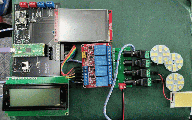

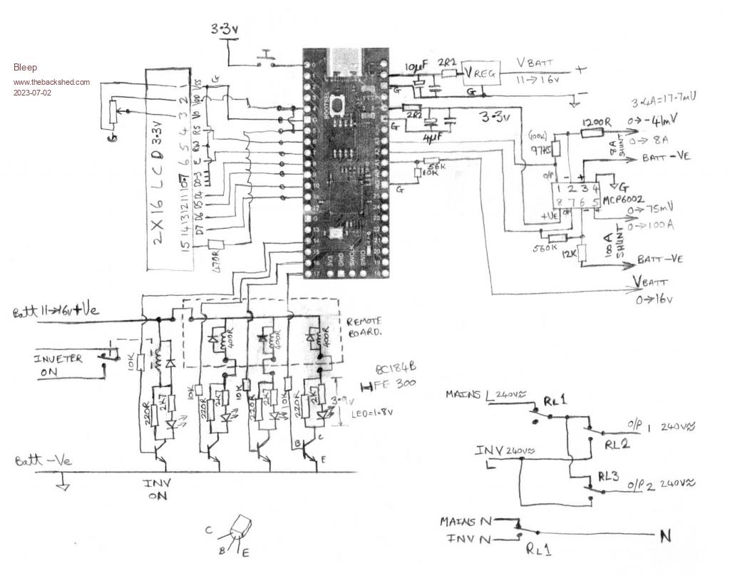

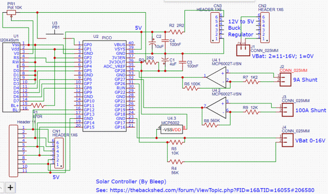

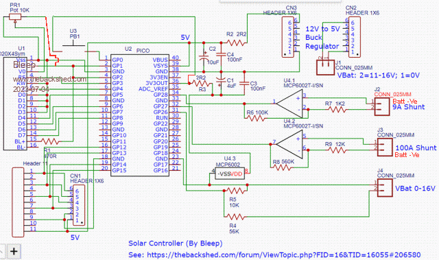

I've attached circuit diagram, photos and code, if anyone cares to have a look.
This is very specific to me, in that it allows for Economy 7 use over solar, if available, the inverter can in theory run both fridge and freezer together, it's about 1.2Kw (maybe), however both fridge and freezer take a hefty surge at start up, 50 to 60A from the battery, so my circuit/program sequences the fridge and freezer in turn, to prevent either of them stalling the other during power up, it also powers the inverter on for a couple of seconds before applying the load, again because of a quirk with the inverter that it ramped up it's output voltage, neither fridge or freezer liked this.
I monitor Solar power IN and Inverter power OUT keeping running totals and if the inverter over currents it is shut off and tried again in 10 minutes, if after three attempts it still over currents the controller goes to fail safe and runs the fridges from the mains and raises an alarm.
In full sun, not very likely in the UK, it will still put in too much power to the battery, in theory this does not matter, there is a separate battery charge controller, however this is a resistor shunt type, so gets quite hot, in this unlikely event my controller will run the inverter continuously, as an extra 750mA drain, otherwise the inverter is only on when needed.
A couple of important totals are saved every hour, using VAR SAVE like Total Wh in/out and a couple of others, a log file is written to when a fault occurs and also every midnight. The code runs at an iteration rate of once per second, it did not need to be any faster, I also use the slowest CPU SPEED to save power, it takes about 5mA from the battery continuously, more when the relays are active, but then there is hopefully plenty of solar power. :-)
The only control is a push switch, quick push for display on/off, long push to force the controller in to/out of battery charge only mode, so I can manually force a full battery charge, or bring it out of charge mode if required.
The controller will only ever allow the battery to go to 50% discharge and will only start running the fridges from solar if the battery is reasonably charged and there is at least 2A coming from the panels, otherwise it uses mains power.
I think that just about covers it, other than to say, this was really quite tricky, not from a software/hardware point of view, but because at one end you've got a couple of 12V 100Ah batteries capable of dumping kW of power in to a short circuit and at the other 240V mains supply! Great care required.
Thanks to Geoff and Peter for enabling me to do this.

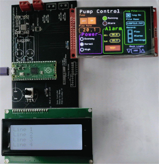

Yes it will be going into a propper box, with display and push button on front, one day!
Regards, Kevin.
PS you could argue that this is in the wrong forum, but for me it was more about the electronics/software and control than it was the solar.

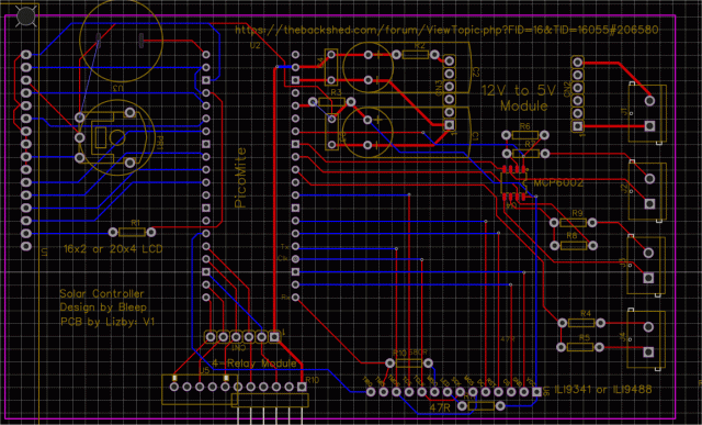

Circuit diagram
Circuit board

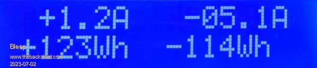

The display cycles through various modes, the top line always shows Input and Output current.
Display showing Total accumulated input and output Wh
Display showing daily input and output Wh
Display showing Battery Voltage and current output Watts

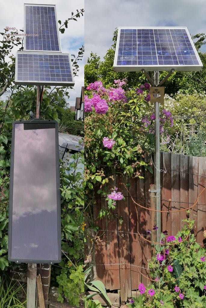

My Solar very small panels, about 60W absolute max, normally in the UK about 45W max.

Posts: 3871
Posted: 04:15pm 01 Jul 2023
Thanks for posting this. Can you explain in words how you ramp up to keep the power-on surge from stalling out the fridge and freezer on startup?
(I know that if I examined the code closely, I would find that, as one of my old bosses said, "The best documentation is a working program".)
Posts: 2547
Posted: 04:50pm 01 Jul 2023
hi Bleep,
   one thing you need to be very careful with is mains arcing from N.O to N.C contacts when a relay switches over. what happens (under load) is that as the common contact disconnects from N.O (or N.C) contact, it draws an arc which is maintained during the transit time to the opposite contact. depending on the setup, the result can be a rather loud bang!
bear in mind that as your inverter and the mains are not synchronized, at any instant there could be 680v (1.4 x 2 x 240) between Inverter Live and Mains Live (and the same for the Neutrals).
in the past i've got around this using an extra pair of small signal relays wired such that a 'turn on' signal can not get through the signal relay until the currently energized main relay is open. this involves using main relays with 3 sets of contacts. it is always advisable to rely upon such mechanical interlocks rather than electronic controls.
rob   :-)

To answer some/most of the above queries.
There were several problems with the inverter.
1 It ramped up it's output voltage over about a second when turned on which neither compressor liked.
2 If a compressor was running and another cut in, the surge was such that the first compressor would often stall.
3 The inverter draws 0.75A even when doing nothing (significant for me), unless turned off.
To over come this, the inverter is kept turned off unless needed.
When the inverter is turned on, no load is put onto it until after a couple of second.
Only one compressor is allowed to run at any one time.
I constantly monitor the current drain out of the battery/solar panel so I can detect either a fault condition, or the fact that a fridge/freezer has turned off on its own.
So the sequence is.
Sufficient sun, mains removed with relay RL1, there is then a delay, the inverter is turned on, delay, compressor RL2 turned on for 10minutes OR the compressor itself turns off due to correct temperature being reached, RL2 turned off, RL3 turned on for 10 minutes OR compressor itself turns off due to correct temperature being reached, RL3 turned off, inverter turned off for 10 minutes, repeat until sun goes or battery gets to 50%.
The 10minutes is arbitrary but both Fridge & Freezer usually cut out before this limit and both are maintaining good temperatures.
This also overcomes any relay contact over voltage, because the inverter is never active when the mains relay is connected. When the mains is isolated, the inverter can turn on and the fridge switching is then all done with the other 2 relays. Under fault conditions, all relays relax, which equates to Inverter OFF, Mains ON, both outputs ON, so both compressors running off mains.
My understanding of Fridge/Freezer compressors is that they always take a hefty surge current, initially, to get them going, once running they run at around 50-70W (in my case) trying to ramp them up simply does not work.
Regards, Kevin.

Posted: 02:28pm 03 Jul 2023
Thanks. Does this EasyEDA Schematic look accurate, considering that the standard Pico module is used, and the 4-relay PCB module shown below is used (either screwed directly into the 11-pin socket (every other pin removed) or via cable using the 6-pin socket)?
The relay module is from here: Aliex 4-relay module
I like this module because it allows V+ as true, and if 5V is applied to DC+, then the 3V3 inputs work (but don't if DC+ is 3V3).

LOL again. My parts boxes are overflowing, but I've never used a 16x2 or 20x4 LCD with the PicoMite, so I thought it would be interesting to try since Bleep had done all the hard work.
  Quote  SPI LCD
Lots of pins free, so easy enough to add:
Choice of 16x2 or 20x4 LCD or ILI9341 or ILI9488 SPI LCD.

Posted: 12:08pm 04 Jul 2023
Hi Lizby,
few corrections to circuit.
Power for the screen contrast pot should come from the switched power, not direct to the 3.3V as I'm unsure what would happen when the LCD module is powered off, but there is still power on the pot, probably nothing.
Power for the PB1 comes from 3V3OUT, wasn't clear, but didn't look like it connected to anything, R3 was in the way.
Power to the OpAmp should go through R3, extra smoothing and noise reduction.
The Current shunts need to be connected as close as possible to the -Ve battery terminal, keeping all cables short and chunky, for example the power cables out of the 100A shunt, on mine, are effectivly short copper jump leads and the 100A shunt is bolted directly to the -Ve terminal.
                                Batt -Ve
                                terminal
Solar Panel in>------+ 8A Shunt +->+>-+ 100A Shunt +-------->Power out
                     J22      J21     J32        J31
Be careful, because the OpAmps are amplifying (relativly) low DC voltages, you have to worry about parasitic voltages popping up, just because a small, or large, current is flowing down a piece of wire.
Regards, Kevin.

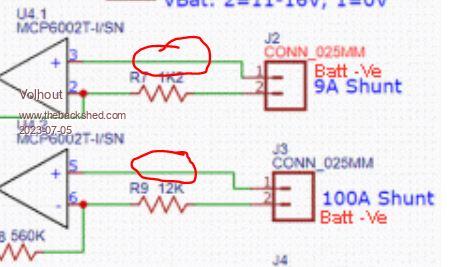

Posts: 6057
Posted: 02:01pm 04 Jul 2023
Hi Bleep,
Inputs like these always make me worry what would happen when something in the wiring is going wrong... or a short circuit happens...
Just put some resistors here...
Posts: 3871
Posted: 02:49pm 04 Jul 2023
Thanks for checking, Bleep. I can't say that the flow of my circuit diagram is very straightforward.
I had already connected PB1 to the outbound side of R3; the MCP6002 is also connected there.
I see what you mean about the pot--I'll fix that.
Can you provide links for your shunts?
Mick--sorry, but for circuits of this sort, I fall far short of *really clever*.
Bleep
Joined: 09/01/2022
Posts: 842
Posted: 03:28pm 04 Jul 2023
Hi Volhout,
Agreed, could presumably simply put 1k resistors in both those inputs as buffering, without affecting anything else.
Regards Kevin.
Bleep
Joined: 09/01/2022
Posts: 842
Posted: 03:41pm 04 Jul 2023
Hi Lizby,
The 100A you can get anywhere, 100A giving 75mV, like this one.
Ebay current shunt
The 8A no, because I made it, from a 10A shunt out of a old multimeter, so it's just a short length of very slight resistance wire, I shortened it a bit then measured the voltage drop for a couple of currents.
You could easily use a 10A shunt from that same link, but you would need to adjust the gain of that OpAmp.
The current gain is set for 17.7mv @ 3.4A or 41.6mV @ 8A approx gain -64, the other OpAmp on the 100A shunt is a gain of approx 47.
I also just remembered that I added two small 100nF capacitors, one across the 100K and the other across the 560K resistors on the OpAmps, again to get rid of ripple & interface, if you want to make your diagram completely correct.
Regards Kevin
