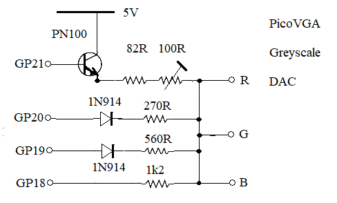

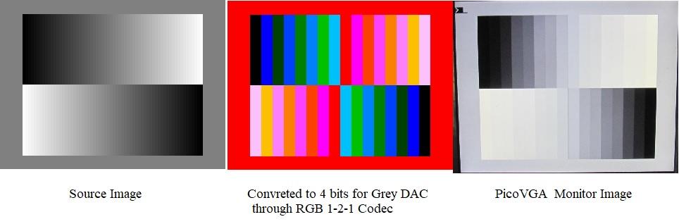

A few people were interested in Grey-scale and RGBI output for the PicoVGA.
Here is the Grey-scale installment with a simplified DAC, RGBI to follow also with a simplified DAC.
Adgust the trim-pot to get a uniform scale. The MSB needs more current than is good for a Pico pin hence the transistor. It doesn't need much gain but does need to work at a high frequency. The diodes reduce interaction between pins. The LSB doesn't need one as it's effect is least significant.
Below is an array of colour constants to use instead of RGB(xxx) for display commands.
They generate the required bits on GP18 (LSB) to GP21 (MSB).
The PicoVGA only uses the Most Significant Bits of each of the 3 bytes in the 24 bit RGB values. For red and blue it is 1 bit and 2 for green, the rest of the bits don't affect the output.
Eg. GP18 is low for 1 to 127 and high from 128 to 255 (between line and frame blanking periods).

Images must first be processed to convert the colours as the PicoVGA codec expects to output to RGB 1-2-1 hardware. A normal greyscale image will come out B&W on the monitor as black and white are the only grey-scale colours.
This program first makes a normal image then converts it to the format required by this hardware.
To keep it simple this is done by loading the image to an LCD screen, reading the pixels, converting the values and writing them back to the screen. One pixel at a time so it is slow!
This cannot be done on the PicoVGA as more than 4 bits/pixel are needed. I used an ILI9488 that returns 18 bits/pixel, though it could be adapted for MMB4W for 24 bits/pixel.
To convert other colour or grey images delete the first section.
It assumes the source image is 320 x 240 pixels.

'Convert an image for grey-scale hardware on PicoVGA (through the RGB121 Codec)

Thanks for this. I'm away from my hardware for a few more days, but would like to try this when I get back. (Just for LOLs, no serious use case.)
Posts: 9081
Posted: 03:06pm 17 Jun 2023
Very nice! It's giving good results.

The switch should ideally be 7 pole 2-way, which would be a wafer switch. It may be cheaper to wire up a second PicoMite. :)

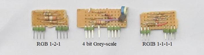

Posts: 3361
Posted: 10:19pm 17 Jun 2023
Re switching, as I don't have a use for this either I have made plug-in modules on stripboard to keep it simple. Also the reason for not using a proper R-2R DAC.
As my PicoVGA is on stripboard adding a socket strip for the modules was easy. For those with PCBs that don't use a 0.1" grid it could be done by replacing the resistors with individual header socket pins and making "hats" to plug in.
Re amplification, Started with the transistor on the output but the extra 0.6V offset made it more difficult to get uniform spacing of the grey levels. Change one and it messes up others.
The current from GP20 isn't that bad. Total resistance is 270R + 50 (pin Z) + 25 (VGA) = 345 R. Voltage drop is 3.3 (supply) - 0.65 (diode) - 0.25 (output) = 2.65V giving 7.7mA.
Also the B-E junction acts as another diode to reduce interaction between pins.
Edited 2023-06-18 14:22 by phil99

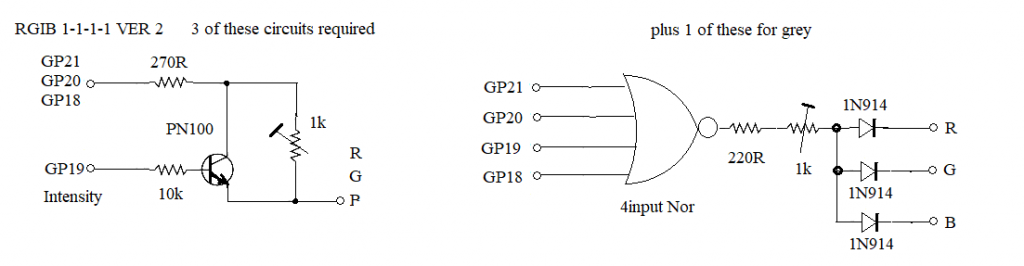

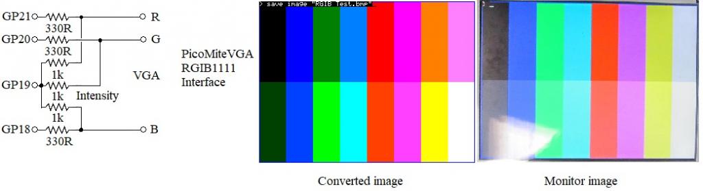

Here is part two, RGBI
Table of colour constants - Number following the colour letter is the bit value. I = intensity. Replace my cryptic names with the colours you see.

You may need to experiment with resistor values to get the effect you want, however this simplified circuit will never be perfect. I tested a couple of much more complicated ones but overall are no better than RGB 1-2-1. With only 4 bits any improvement in one aspect of an image is at the expense of another.

Posts: 6050
Posted: 08:25am 18 Jun 2023
Hi Phil,
Your RGIB has only 9 colors.. Not that it matters.
The greyscale may be interesting. When we standardize on this config Peter may even be able to add this to the options, and scale real RGB() values to ti using a lookup table.
I myself would be most interested in 16 level greyscale in 640x480, but since memory restrictions force to tiles in this mode, greyscale would be a real pain.
Posts: 3361
Posted: 08:40am 18 Jun 2023
On the monitor I count 16 colours, though the differences are not great.
With the intensity bit low:-
black, blue, green, cyan, red, magenta, yellow, light grey.
With the intensity bit high:-
dark grey, light blue, light green, pale cyan, pink, pale magenta, pale yellow, white.
The I bit adds brightness to all colours simultaneously, desaturating them.
As noted previously it isn't worth the the effort, different but not better.
A few others were interested in the idea so now they have a starting point for their own experiments.
Edited 2023-06-18 18:53 by phil99

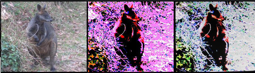

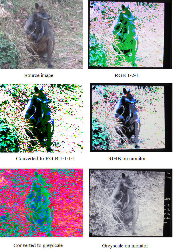

Posts: 3361
Posted: 05:25am 22 Jun 2023
A comparison of the three decoders.
In this instance RGBI looks a little better than RGB121 as it can display 2 shades of grey. In some other images RGB121 is better.
However greyscale is best.

Posts: 6050
Posted: 12:07pm 22 Jun 2023

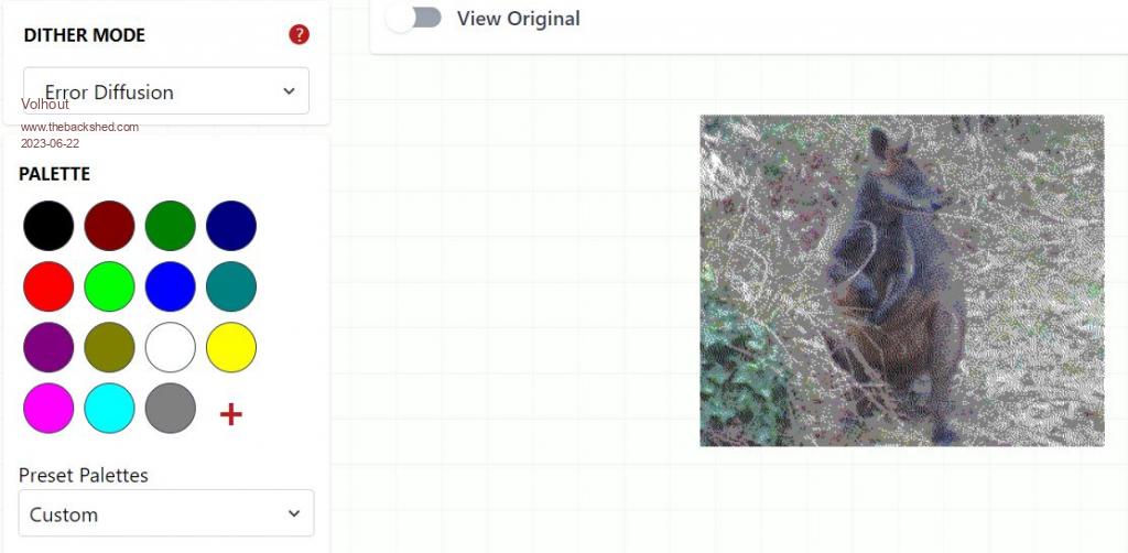

Hi Phil,
This is FloydSteinberg on your (grabbed) original picture on Pico RGB-121 in 320x240. Yes, it is noisy, but it is clear what it presents.
Edited 2023-06-22 22:09 by Volhout

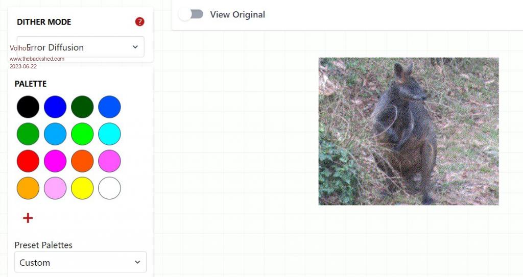

Posts: 6050
Posted: 12:50pm 22 Jun 2023
This is RGIB-1111 mode dithered. For some reason it looks not as good as RGB-121.
But that may be this particular picture that does not match with the palette.
Posts: 3361
Posted: 12:57pm 22 Jun 2023
Here is what the RGB121 dithered one looks like on the Pico.
The settings for dithering may need optimizing.
Perhaps before dithering the size needs to be 320 x 240 pixels or less.
When I resized the dithered image to fit the Mode 2 screen it probably messed up the dithering.
Edited 2023-06-22 23:05 by phil99
Posts: 3361
Posted: 01:45pm 22 Jun 2023
@Hawk
The requirement is for 700mV output with both colour and intensity pins high.
That is achieved when the parallel combination of the 2 resistors that go to each VGA pin is 250 ohms. 560R || 470R is close. 680R || 390R may also be worth a try.
EDIT
No, going senile.
910R is the minimum for the I pin as there are 3 in parallel.
You could add a transistor connected the same as in the greyscale circuit to drive lower values, however lower values will make the colours very pale.
The solution is to add a transistor||resistor in series with each of the colour pins, controlled by the I pin.
Tried this when Mode 2 was first introduced but didn't consider it any better than RGB121.
Edit 2
Here is the circuit, as best I can remember.
The RGIB image converter will need to be changed to match the different circuit, after the values of the variable resistors has been set.
The individual 8 bit RGB(r,g,b) values correspond to the VGA pin voltages - 0 to 255 = 0 to 700mV. So by measuring the output voltages on a scope for all 16 colours you can see what values are needed in the converter program.
Without the optional Grey circuit there are 2 Blacks so only 15 colours. It turns Black Low intensity to grey, Black High intensity remains black.

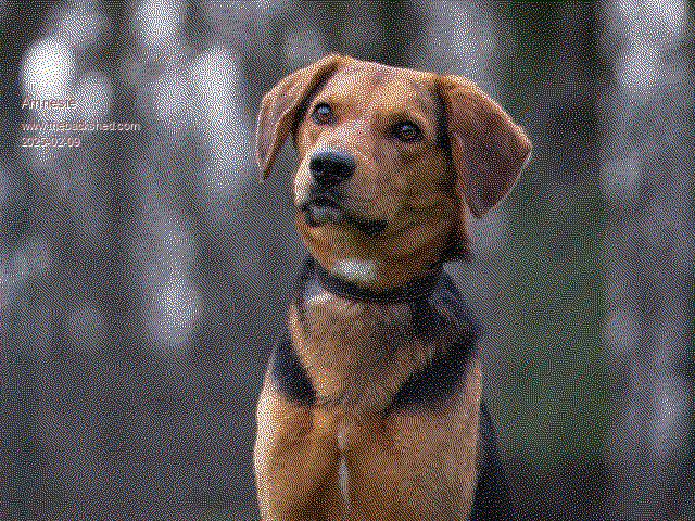

Amnesie
Joined: 30/06/2020
Posts: 763

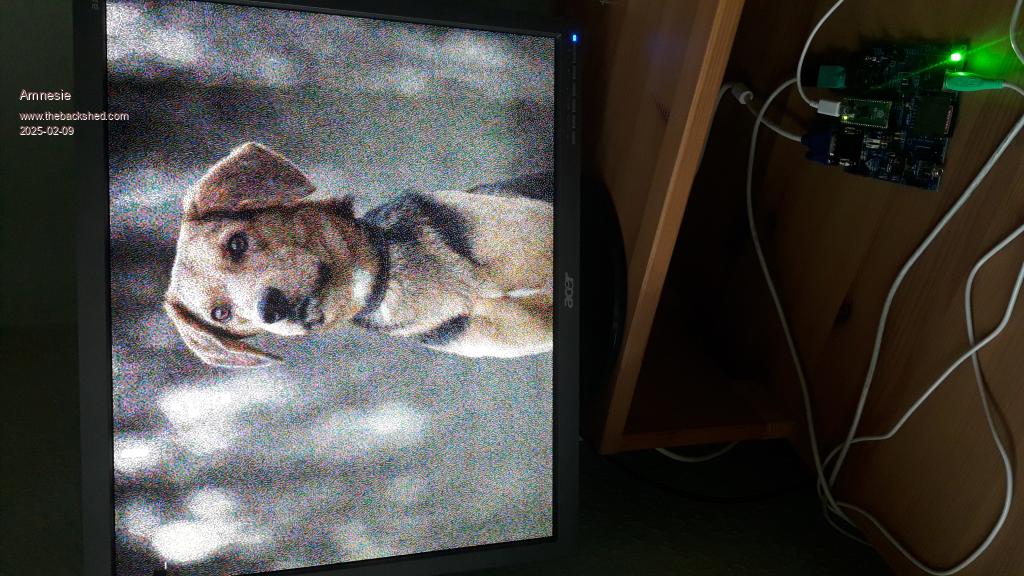

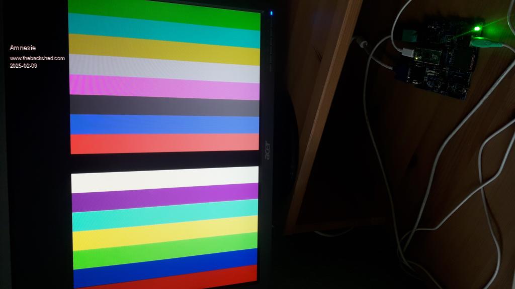

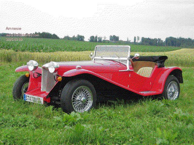

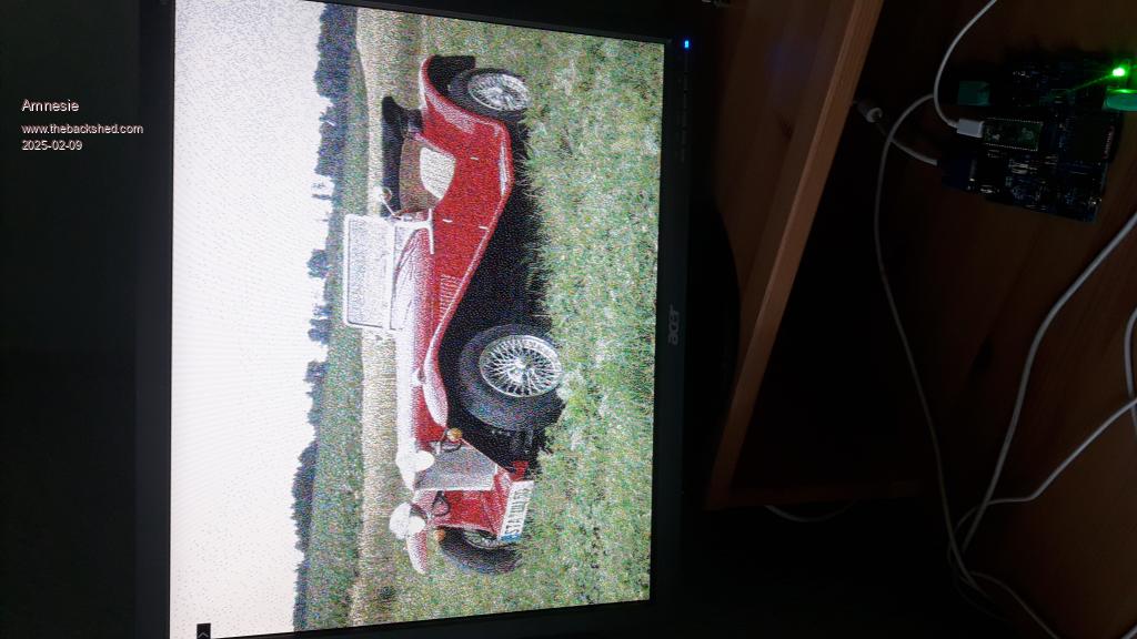

Posted: 10:04am 09 Feb 2025
Hello,

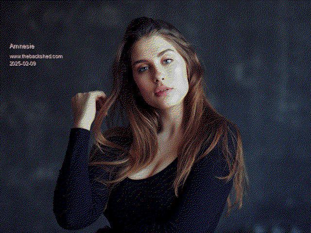

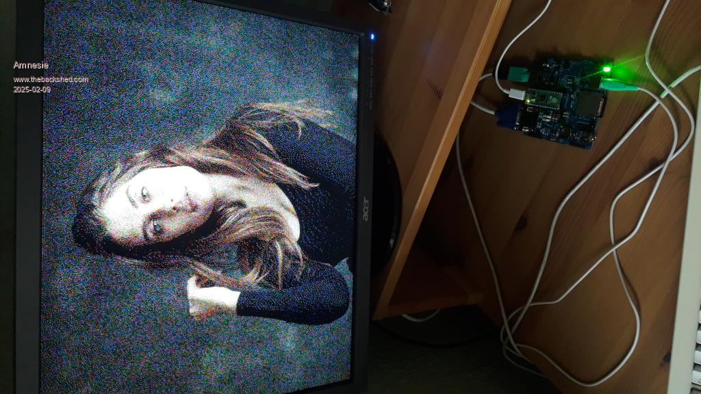

now that the PICO 2 supports higher (double) the resolution of the old PICO in VGA with 16 colours. I converted some pictures and was really pleased with the results, BUT no matter what picture I am choosing for dithering (and in general)
I feel that the C64 colour pallet is far superior to the PicoMite colours.
See for yourself:
Original Image:
Standard colour pallet:
C64 colour pallet:
(Error Diffusion Dithering with Floyd Steinberg)
I am aware of the fact, that the colours are somewhat "hardcoded" via the resistor network. What modification would be needed for a C64 colour pallet? I mean how do you come up with those adapted resistor values (how can I calculate them?)
EDIT: the forum software compresses the pictures (in a nice way) but sadly now you can't really see how bad the original colour-pallet is... In real in looks A LOT more magenta... I prefer the c64 in any case.
I attached a archiv with all three pictures:
pics.zip
Greetings
Daniel
Edited 2025-02-09 20:09 by Amnesie

Hi Amnesie,
Can you check if the color palette of windows95 (the 16 color palette) generates better dithering ?
With the current 4 bits output, that color palette is easy to generate in hardware...but.. you need new names for the colors.
I tried this with a kangaroo picture 2 years ago, and then it looked a bit better. See post of june 22, 2023.
And it included grey...
pico                           VGA
R ------------ 390 -----------+--R
Gmsb --------- 390 --------+-----G
B ------------ 390 -----+--------B
         +--- 820 -----+  |  |
Glsb -----+--- 820 --------+  |
         +--- 820 -----------+
