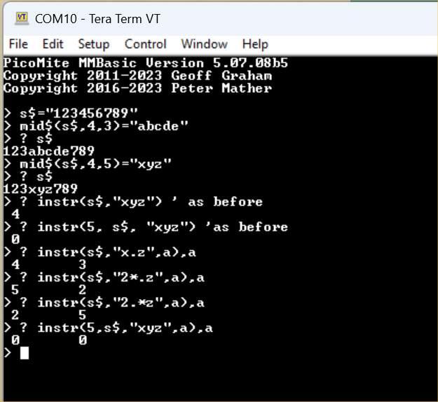

The MID$ command can now insert a string that is a different length than the selected section
Full, optional implementation of regular expressions in INSTR and LINSTR
INSTR([start],text$, search$ [,size])
LINSTR(text%(),search$ [,start] [,size]
In both cases specifying the size parameter causes the firmware to interpret the search string as a regular expression. The size parameter is a floating point variable that is used by the firmware to return the size of a matching string. If the variable doesn't exist it is created.
e.g.

Another good use is to substitute sub-strings in strings using the new flexibility in the MID$ command
e.g.
