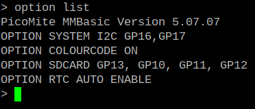

Hi all;
What am I missing about the GOSUB command?
I get this weird error "Error : Invalid character:" when I use GOSUB Test, but if I just use the word test and leave out GOSUB, it executes the subroutine correctly????
I have supplied an example in its simplest form.
Details;
