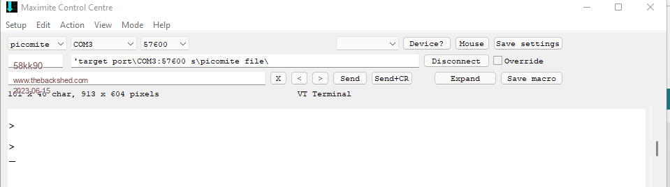

Thank you for the reply, tried that nothing happens, I have the MMCC window open which
shows connected, and MMEDit open.
Clicking Action on the MMCC toolbar nothing happens, there is nothing shown in the MMCC window and nothing displayed in MMEDit.
MMedit is v5.1.5 and MMCC is v5.1.5 also.

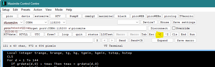

Posts: 6631
Posted: 06:00am 15 Jun 2023
MMCC is a terminal
You can either send ^C from the terminal area (where the text appears)
or
4th row of buttons, towards the right there is a ^C button.
Either way works

Hi Jim,
My MCC window seems to be missing the line that has the Tab ^c ^z CLS End Run buttons!
I did put ^C in the white terminal box and hit send and that seemed to work fine.

Posts: 6631
Posted: 07:04am 15 Jun 2023
By default, all 6 toolbars are turned on and visible.
You must have turned some of them off.
Look in the 'View" menu and try turning them back on.
Currently there is no facility for macros to include menu items and I have no plans to change that.
You are stuck with two mouse clicks to do the transfer.
58kk90
Joined: 14/06/2023
Posts: 82
Posted: 01:16pm 15 Jun 2023
Hi Jim
I cannot remember disabling the toolbar, but must have done so, anyhow I have re-enabled it and now I have all the same buttons as your picture, incuding the one with ^C on it!
From what you say, I am assuming there is no simple 'command' that I can put in the macro then to send the listing to the editor, it has to be the menu item.
I put in \c LIST ALL \r into a macro and that stops the running  program and then shows the listing in the command window.
