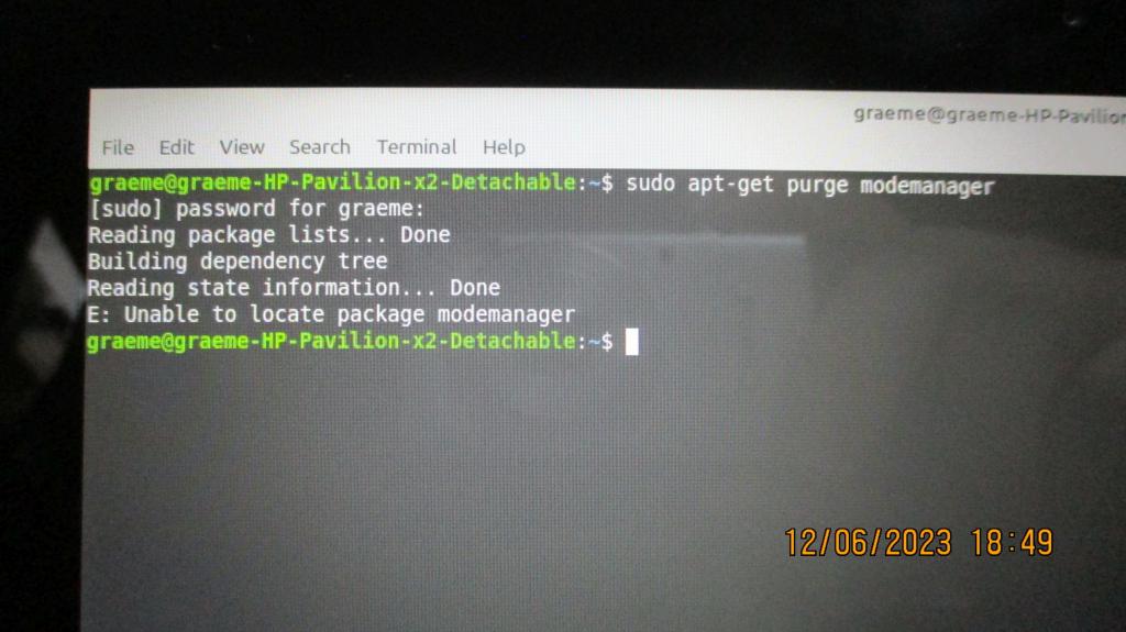

You might have to get rid of modemmanager
sudo apt-get purge modemmanager
The commands to get rid of it may vary. Search the forum.

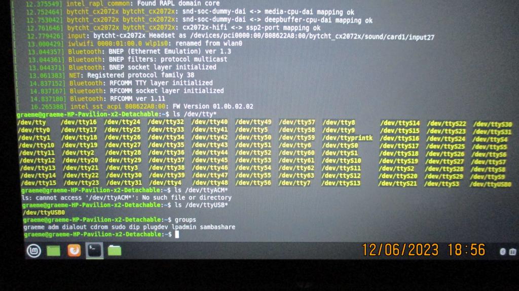

to see the groups you are in: groups
to add an existing user to an existing group:adduser <user> <group>

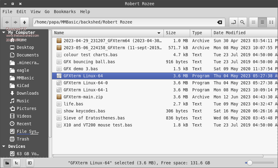

@ Rob - can you link me to the Linux version of GFXterm?  I only have the Windows ones, and I can't remember where I got those from now!

@ Quazee137: This is the output I get from those commands...

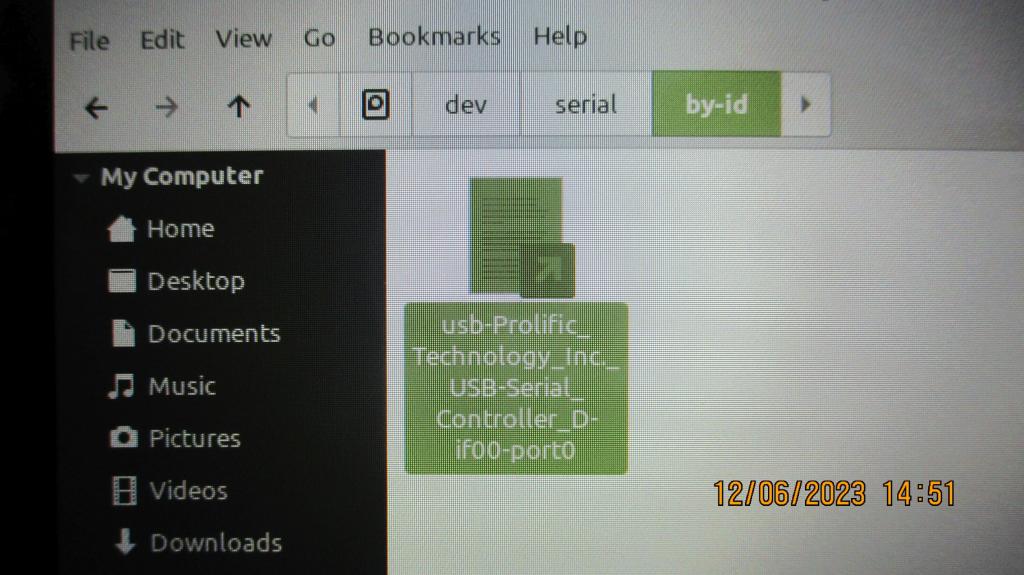

From what I can tell from this, I am already a member of the dialout group, and I think the Prolific adaptor is at /dev/ttyUSB0.
Inside PuTTY, I cannot select /dev/ttyUSB0.  All it will let me select is /dev/ttyS0.

EDIT: Hold the phone - In PuTTY, right down the bottom of the config window, under Category, I can enter in the /dev/ttyUSB0 reference there, and it seems to open OK.

Modemmanager,
NOT
modemanager!

  Quote  Modemmanager,
NOT
modemanager!
F-ing Linux!
Totally missed that extra "m" - very well hidden.....
In any event, it did not seem to matter, as the COM port is working now.

I have now removed modemmanager using the extra m this time.  It completed without errors, so that should now be gone.
EDIT: @ Rob - Can download the file, but Mint does not know what to do with it.  Mint moans that the file has no application associated with it.  The file has NO extension, and the W10 machine I downloaded it on, just refers to it as filetype "File".
Do I need to rename and add an extension perhaps?

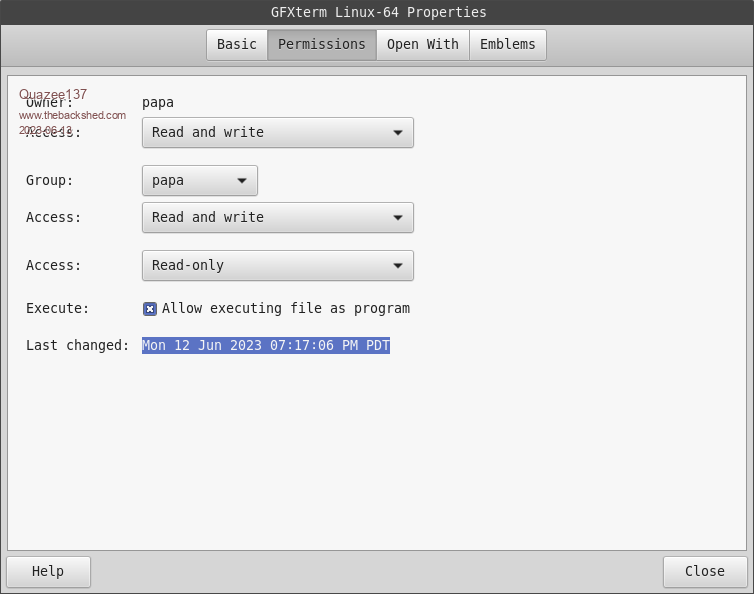

right-click on the file's icon and select 'Properties' from the menu. this will bring up a window with three tabs, the right-most is the one you want, 'Permissions'. here you will find a checkbox with the text "Allow this file to run as a program".
check this checkbox, this will then allow the file to be run.
with linux, extensions don't have any special meaning in the same way as they do with windows, so no need to rename anything.

bring up nemo or other file mgr you use
right click on
click box
from here on in it should just run.
