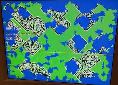

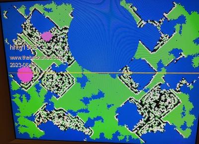

two screenshots and one small movie...

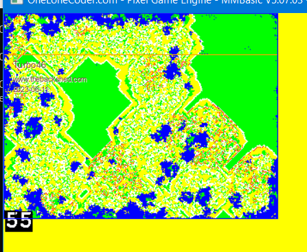

Yes MMB4W does have graphics, this is a display:
It only displays on a small section of the screen. I've not tried it on the CMM2 yet.
I see that you are using a Mac so MMB4W is not so easy. The program just starts and it's not clear what is happening if you don't already know. If the start screen shows something like:

ecological simulation. yellow is desert. green is grass. white is sheep. red is wolfe.
you can press h or ? for help. there are several functions: atomic bomb. poisoned rain etc. try the keys...
if you change mx and my (320x240 at this time - for the picomitevga and mode 2...) you can have a greater 8or smaller) area...
i will integrate the hint to help at the beginning...
