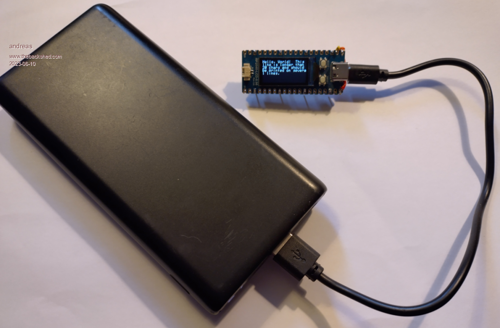

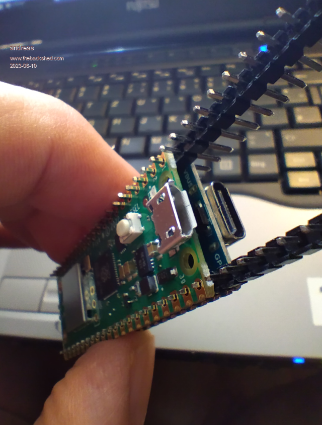

Posted: 11:37am 10 Jun 2023

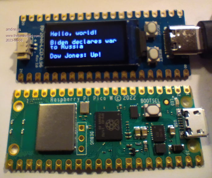

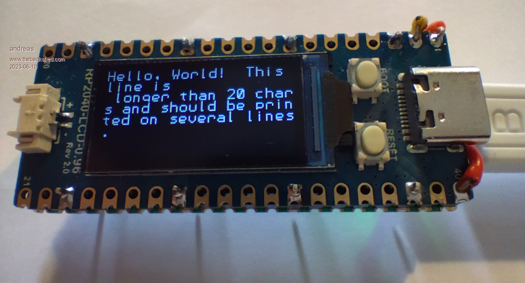

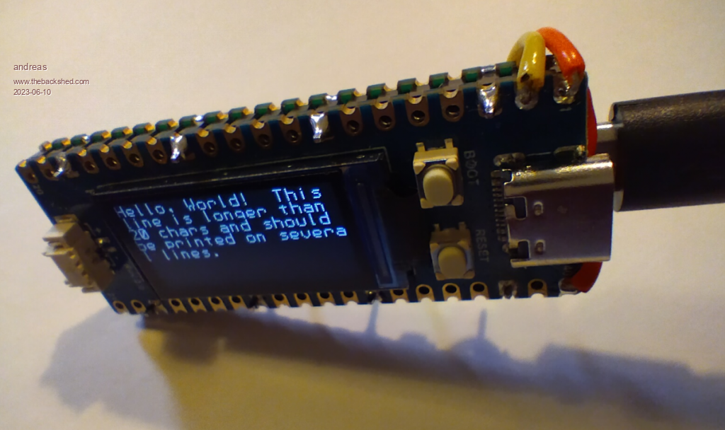

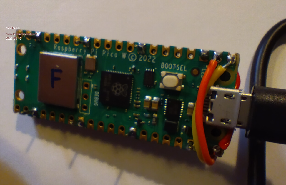

Hello all,
here it is: The WebMiteLCD :-)
Step1: putting them together this way
WebMite on top, RP2040LCD on the back
Soldered are: GND(8x),VBUS,GP0 and GP1 (Null modem, crossover)
All other header pins are dragged out after soldering GND lines

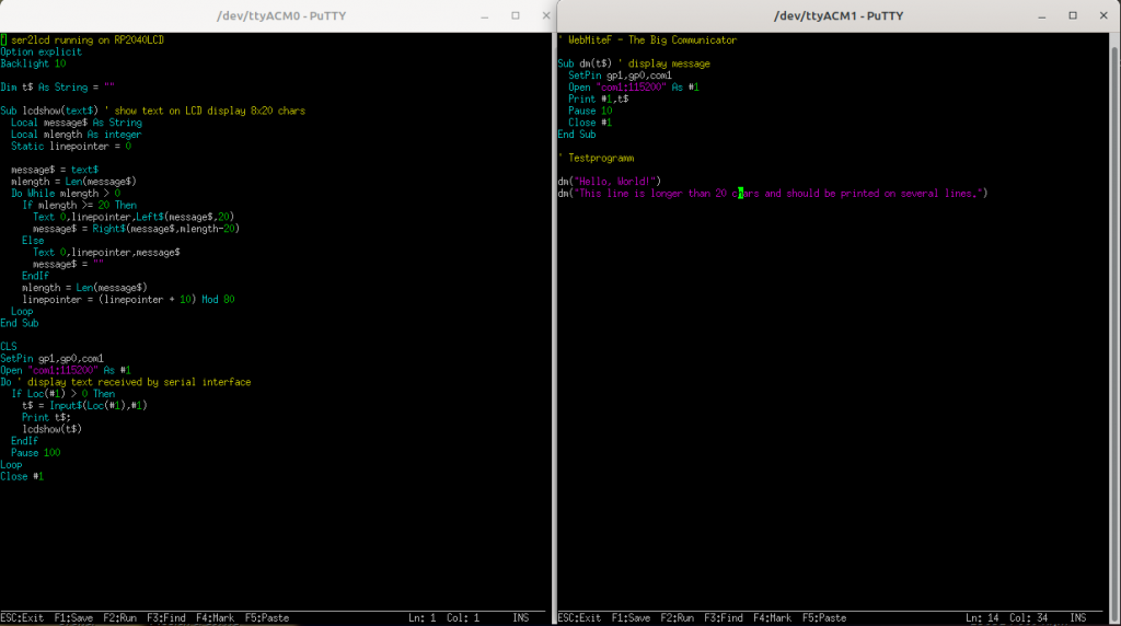

Step2: The Software
Left side: RP2040LCD showing everything received by COM1:
> list
' ser2lcd running on RP2040LCD
Option explicit
Backlight 10
Dim t$ As String = ""
Sub lcdshow(text$) ' show text on LCD display 8x20 chars
 Local message$ As String
 Local mlength As integer
 Static linepointer = 0
 message$ = text$
 mlength = Len(message$)
 Do While mlength > 0
   If mlength >= 20 Then
     Text 0,linepointer,Left$(message$,20)
     message$ = Right$(message$,mlength-20)
   Else
     Text 0,linepointer,message$
     message$ = ""
   linepointer = (linepointer + 10) Mod 80
CLS
SetPin gp1,gp0,com1
Open "com1:115200" As #1
Do ' display text received by serial interface
 If Loc(#1) > 0 Then
   t$ = Input$(Loc(#1),#1)
   Print t$;
   lcdshow(t$)
 Pause 100
Close #1

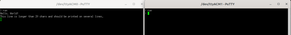

Right side: WebMite sending a text$ to COM1:
> list
' WebMiteF - The Big Communicator
Sub dm(t$) ' display message
 SetPin gp1,gp0,com1
 Print #1,t$
 Pause 10
 Close #1
' Testprogramm
dm("Hello, World!")
dm("This line is longer than 20 chars and should be printed on several lines.")
-andreas

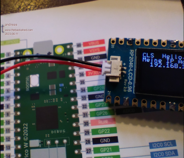

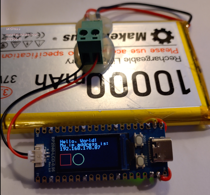

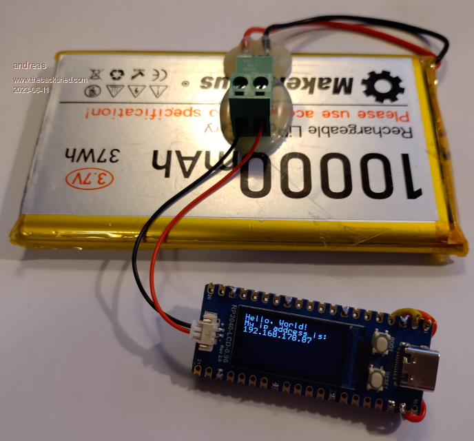

Today I have received tiny cables with a connector fitting into the tiny accu connector of the RP2040. The colours are wrong (black and red!). Then I saw that it would be better to connect VSYS to VSYS and not VBUS to VBUS as I did it. The diode seems to "protect" the WebMite pico w from power sourcing from the battery connector of the RP2040. So I will change that hardware design.
-andreas
