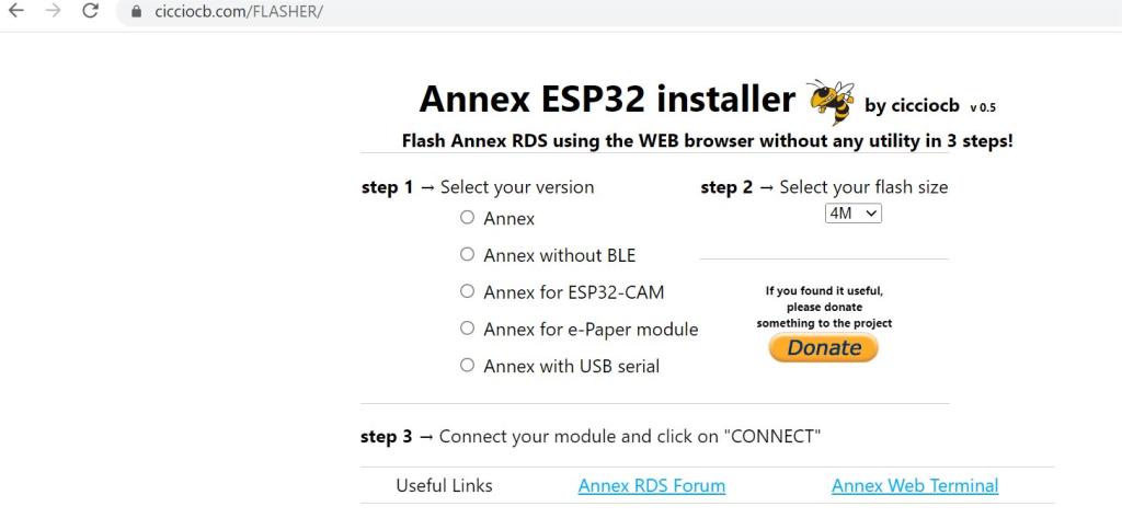

The new way to flash ESP32 with Annex using just a browser https://www.cicciocb.com/FLASHER/

Posted: 05:29pm 03 Jun 2023
I used the Annex link and it said it flashed and the log shows info about internet address but no vga so not a clue.
Posted: 05:35pm 03 Jun 2023
  Mixtel90 said  It seemed to install ... completely useless to connect to it
Just now worked for me with an ESP32 D1 Mini. It flashed successfully, I unplugged it and plugged it into 5V power (because sometimes USB from a PC is insufficient), connected the WIFI to the ESP device which showed up, put the 192.168.4.1 IP address into the browser, and got the config page. From there, I gave it a fixed IP address and the wifi AP name and password and the time zone info ("AST4ADT,M3.2.0,M11.1.0" for me) and saved and rebooted. Now it comes up in the browser with the IP address I gave it.
