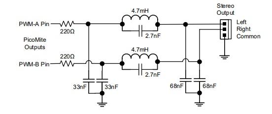

I finally got around to trying out the playing of some WAV files via the PM, and I must say, I am extremely impressed with the new LPF design as in the manual, page 31.
I believe that Volhort had something to do with the design of this filer?

In essence the picomite has dual PWM (left/right audio) running at 44.1kHz (CD sampling frequency) or lower. The WAV file contains DAC values,and these are send to the PWM (after some scaling for i.e. volume). The PWM acts like a DAC, but it has one drawback. The PWM frequency (i.e. 44kHz) is stronger than the audio in it.
We are lucky that we cannot hear 44kHz, but audio amplifiers can, so there is a filter that removes the 44kHz. It is a very good solution for CD audio.
But ... it will not be perfect in removing other frequencies  (i.e. if you play a 16kHz sampled waveform). In that case the MCP4822 DAC that Peter also prototyped is better.

It's all done by the built-in PWM handlers on the RP2040. There's no DAC. Volhout did indeed design the filters. All versions of them since Geoff's original RC filter.  :)  Getting rid of the 44kHz carrier is non-trivial.

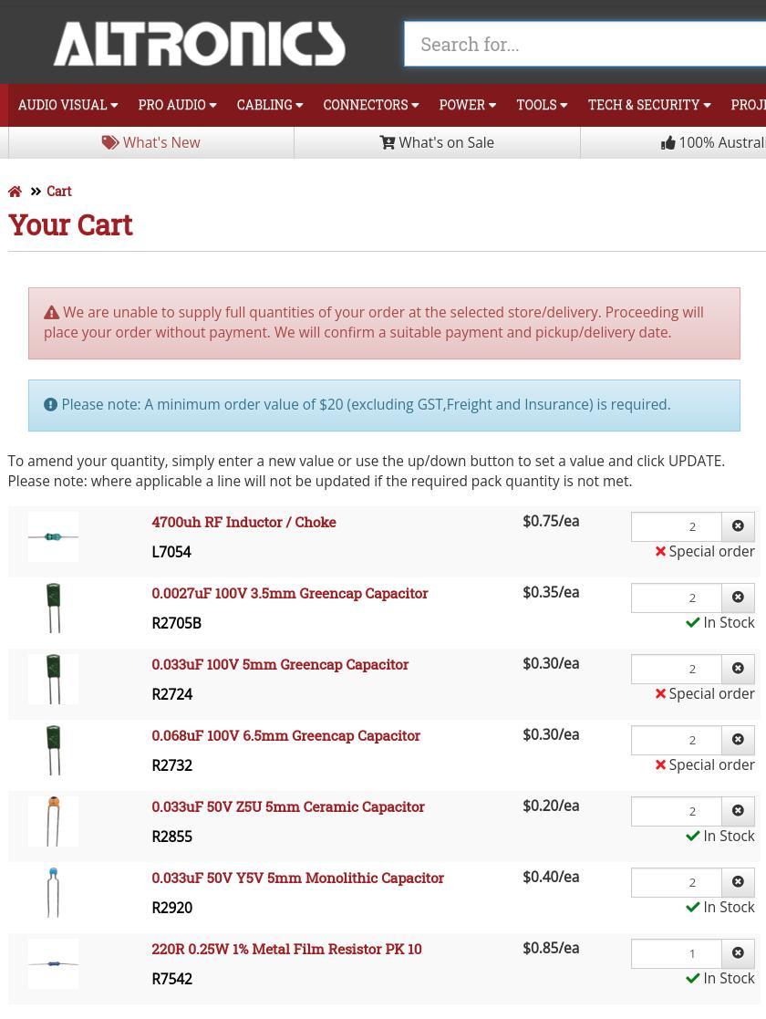

This is good news, as I am also planning to add audio to my Silicon Chip PicoMiteVGA.
Has anyone created a shopping list for the components?
I'm guessing that the resistors are all 1/4W common resistors, and the capacitors are common ceramic capacitors, but I am unsure about the inductors.
Will these ones from Altronics do the job?
Altronics 4.7mH inductor
2.7nF also seems to be less available than other values (2.2nF or 3.3nF).  Probably means an online order, unless these would do the job.
Jaycar 2.7nF Capacitor

Altronics shopping list added.  I'm not sure which capacitors are best to use for audio.

The film capacitors are best, but the ceramics also work fine. I have used both for the 2.7nf. My boards all have film caps for the 33nf and 68nf.

Posted: 10:23am 31 May 2023
  Volhout said  The film capacitors are best, but the ceramics also work fine. I have used both for the 2.7nf. My boards all have film caps for the 33nf and 68nf.
Thanks for that.  Looks like Altronics, which is just down the road from work, don't keep some of the items in stock, so I may have to just bite the bullet and pay for Element 14 or Mouser postage.

Don't put the inductors side by side. If you have to do something like that then put other components between them to space them apart. Even better, put them at 90 degrees to each other. You don't want cross-coupling between them and putting them at 90 degrees lets you put them much closer together.
Try to get as much of the audio filter away from the PicoMite as you can as any noise picked up will be amplified.
If you can, run a clean earth trace from your power input pin to the audio output socket. That prevents heavy noise pulses getting into the audio. Alternatively connect them using a copper pour (ground plane).
Disable the on-board switcher by connecting 3V3EN to GND and use a linear 3V3 LDO regulator. This will reduce the noise level a lot.

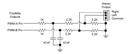

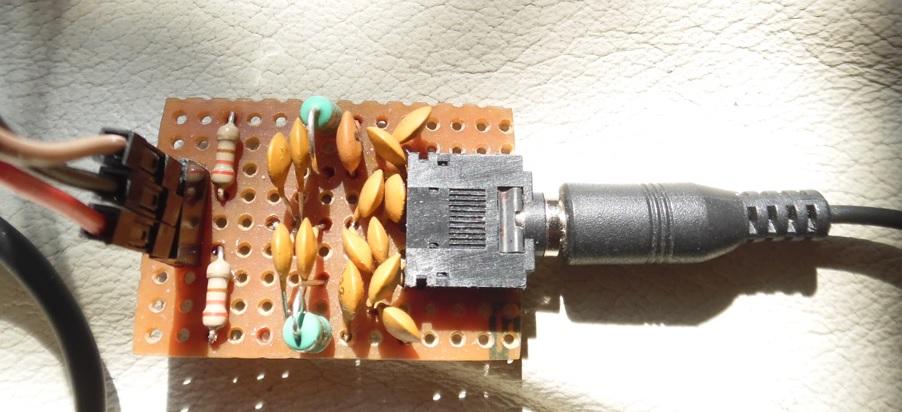

Posted: 03:44pm 31 May 2023
I built the non vga circuit but it must have changed to preferred capacitor values. I had to parallel and series the caps I had to get the values.
My circuit was then more un-necessarily complicated.
Is this vga manual circuit ok? It's simpler.
Posts: 9252
Posted: 04:03pm 31 May 2023
It will work after a fashion, but the filter isn't as steep and doesn't reduce the 44.1kHz by very much at all. It's nowhere near as good as the inductive version.

Posted: 04:49pm 31 May 2023
I had the preferred value caps used but the circuit seems updated since I built it.

Posted: 07:33pm 31 May 2023
  LucV said  I am still using the old version of the filter (the one from the VGA manual stanlyella posted) and I was blown away when I first heard it.
Oh, and no !!
You may not use this idea for the upcoming contest.........
If this is the old version where is the latest version/circuit please?

Posts: 6200
Posted: 03:43am 01 Jun 2023
Hi Grogster,
The inductors you specify are fine. In general you will find leaded inductors in the range of 10-30 ohms internal resistance. These ones are 20 ohms.
note: In the earliest discussions on the filter I designed with different values. With these different values the filter was more critical on parameters, and it would require certain manufacturer/type number with narrow tolerance. Not anymore. The final 4.7mH filter is easier on tolerances.

The audio output is PWM when using the filter, and DAC when using the MCP4822 DAC.
To remove the 44kHz from the PWM signal the simplest option is a filter.
More advanced methods can be implemented, but these required significantly more electronics. Alternatively you can use an electronic FIR filter (chip) but that requires you to provide a clock signal.
The inductor filter is simply the simplest solution, not requiring any extra IO pins, is relatively cheap and forgiving.
The filter in the older VGA user manual (and on the earlier VGA picomite designs) is not performing as well, but may be adequate for some applications.
