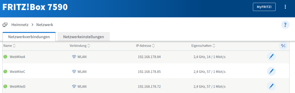

Hi Matherp,
is it possible to add a string to the webmite name ? i have 3 webmite atm and all called Webmite. maybe add name$ to option wifi "wifiname","password","Kitchen01"
or add the MAC adresse ?
thx
Plasma

Plasmamac
Joined: 31/01/2019
Posts: 620
Posted: 12:24am 02 Jun 2023
Hmm my vodaphone router hasn’t this option so i edit the Webmite ascii   in the uf2 file. Works

circuit
Joined: 10/01/2016
Posts: 310
Posted: 04:57am 02 Jun 2023
  Plasmamac said  Hmm my vodaphone router hasn’t this option so i edit the Webmite ascii   in the uf2 file. Works
How do edit the .UF2 file? - i.e. what program do you use?
