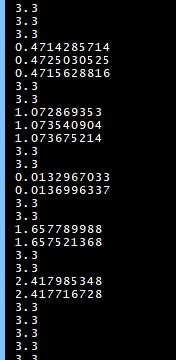

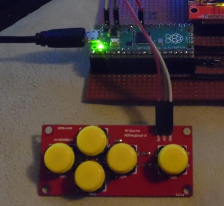

Hi. the quid button pads arrived and seem to work. Using at 3.3V though they're arduino so for 5V. results for up,down,left,right,right button.
SETPIN 31, AIN
do
PRINT PIN(31)
pause 1000
loop

It works well. My tron game is much more playable compared to touch area buttons.. and poking lcd screens is not good for them.Good button pad for the price of a mars bar and uses just 1 pin.

Touch buttons work but not too good with finger presses. The button board is much better and the buttons click when pressed but pressing 2 buttons at once needs another look at. Handy board for the price.

I'm impressed it's so simple yet works. switches and pull ups and de bounce and wires and lots of gpio pins l8r. for 5 buttons this is handy.. in the spirit,hobbyist
