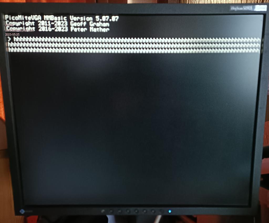

I've a problem on my TFT monitor with the VGA output of the picovga.
When printing a full line of characters I see some characters unsharp. I tried to make a photo of it.
You see at the nearly end of the line that some characters are not as sharp als those in the begin of the line. What could cause this problem? I tried different power supplies. The problem keeps.

You say the monitor works great on another system, is that using the SAME cable?
Assuming that the main issue is an out of focus picture, It;s difficult to tell what the issue is at the right hand side of the line, I can see some something but it's hard to say exactly what.
You need to hang a scope on the RGB lines and see what is going on.
Also try the monochrome mode if that is not already in that mode  and see if that makes a difference.
I'll guess that something is getting on top of the video signal, and my first suspect would be the horiz sync.
Try filling the scree up with characters as well, you might see some other artefacts that will give you some clues.

Did you try other chars? Is h the worst one?
I'm thinking if you can find a worse pattern it will show up easier with a scope or the like.

What is the native screen size of your monitor?
If it is not a multiple of 640 x 480 the monitor has to convert and often ends up with some sections looking out of focus.

Agreed.  I find the focus and sharpness is perfect on older 4:3 LCD monitors, which can still be had, as this is then the native format for the output of the VGAmite.
However, 16:9 screens are by far more generally easier to come across, and as Jim says, the monitor itself will stretch the image to FORCE it into 16:9, which often makes the characters look "Fat".
Have a look in your monitor settings - many monitors have a setting where you can turn image stretching off, and then the image will just be centered on the screen, and not stretched to the left and right.  What the monitor manufacturer calls that "Feature" varies from monitor to monitor, so I can't be more specific.
EDIT: Oh, and BTW, I myself also had this kind of fuzzing of characters on 16:9 monitors.  The way I fixed it forever, was to dig out and press back into service, one of my old 4:3 "Square" shape computer monitors.  The output is crystal clear and sharp as a knife on those older monitors.  But, you may not have access to one of those.  Computer repair shops probably have stacks of them out the back, so if you visit one, they can probably sell you one of those older square shaped panels for about twenty bucks or so.

Thanks for all the replies.
Grogster did light a light in my thoughts.
I have found an option in my 4.3 monitor and it's called fase.
I adjusted this until the artifacts where gone. My new 16.9 monitors have problems with the resolution of the picovga. The picture looks good at first glance but the artifacts are worse then on 4.3 and of course the circle looks like a flat egg. (ratio problems). Fortunately I got an old professional 4.3 monitor from a friend and with the fase adjustment I got all right.
