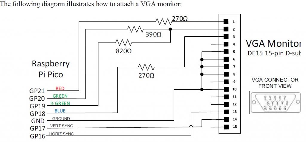

Why not use the 4-resistor VGA circuit? It's a lot easier and you don't need a trimmer. :)

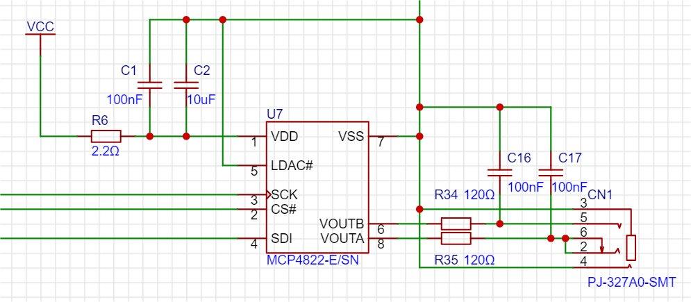

Ok, here's the schematic pinched from Peter's EasyEDA project:
If it's the only SPI device, then /CS could be tied low, so only 4 pins need to be wired: V+, V-, SCK, MOSI/SDI (but maybe the firmware needs for CS to be specified).
Edited 2023-06-09 23:20 by lizby
Posts: 9252
Posted: 01:20pm 09 Jun 2023
I think you may need CS# as part of the SPI synchronising process. Not sure.
Consider yourself lucky that you don't need LDAC# too. :)
Posts: 12078
Posted: 01:35pm 09 Jun 2023
Without CS it won't work

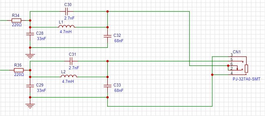

Here's the inductor circuit from the EasyEDA V1.0 file:
I don't have and can't find on aliexpress through-hole 2.7nF capacitors. Will either 2.2nF or 3.3nF suit?
Posts: 9252
Posted: 02:10pm 09 Jun 2023
You'll get something, but it won't be as accurate as it should be as it's a tuned circuit. A 1nf and a 1.5nF in parallel would be closer.

  Mixtel90 said  Why not use the 4-resistor VGA circuit? It's a lot easier and you don't need a trimmer. :)
Which is that one... All the cicuits I have seen requires a green trim to get the white
as best as possible?
Can you show me the one you are talking about all the circuits from Geoff's site have the 8 resistors?
