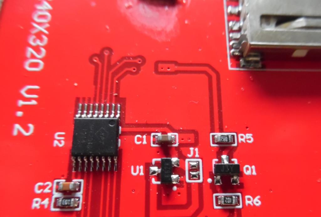

Posted: 06:34pm 23 May 2023
look at the back and j1. it shorts the 3.3V reg

Hi Tom,
There are 4 circuits on the red ILI0341 LCD board:
1/ The SD card. The SD card is normally powered from the 3.3V from the picomite.
2/ The touch controller. This is a 3.3V chip
3/ The LCD chip (the ILI9341), this is a 3.3V chip
4/ The backlight LED.
Circuits 2 and 3 can be run from the pico 3.3V regulator when you short the J1 jumper Maybe even without shorting it, since the regulator will output roughly 2.9V when powered from 3.3V. And with 2.9V both chips should still work.
But...
(I just measured it on my board to be sure of this).
The backlight LED has lower brightness at 3.3V. You may want to test this first.
I normally have it connected to 5V through a resistor. When I connected it directly to 3.3V (no resistor) it worked, bus was not as bright as 5V.

Posted: 09:07pm 23 May 2023
IIRC the LCD pin on the ILI9341 (the later versions at least) is only connected to the base of a transistor via a resistor (1K springs to mind). The backlight LEDs are its collector load from VCC. That's why you can switch the backlight on and off or PWM it from a PicoMite pin. There's no way to dim the display with a resistor unless you put it in series with VCC. Trying to dim the display by starving the switching transistor of base current could lead to it frying. Connecting LCD to a supply via a 50R resistor will do no harm, but it won't affect the brightness. You can simply short it to VCC (3V3 or 5V) if you don't want to control it.

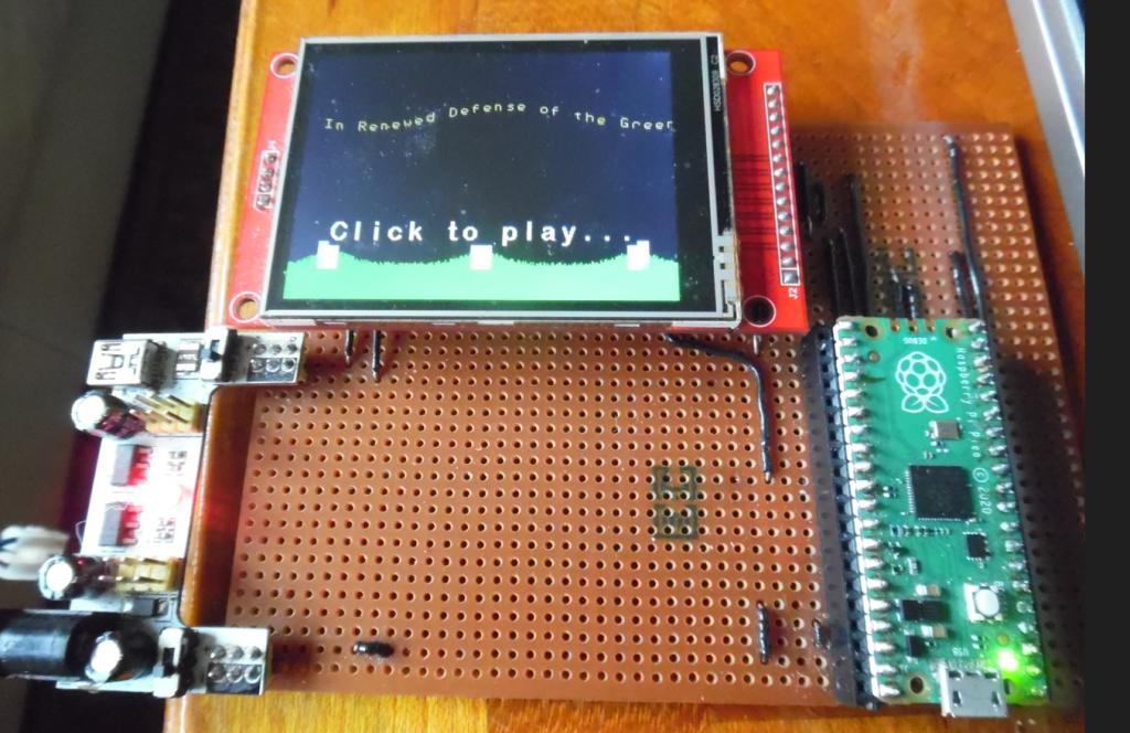

Posted: 09:44pm 23 May 2023
  Mixtel90 said  IIRC the LCD pin on the ILI9341 (the later versions at least) is only connected to the base of a transistor via a resistor (1K springs to mind). The backlight LEDs are its collector load from VCC. That's why you can switch the backlight on and off or PWM it from a PicoMite pin. There's no way to dim the display with a resistor unless you put it in series with VCC. Trying to dim the display by starving the switching transistor of base current could lead to it frying. Connecting LCD to a supply via a 50R resistor will do no harm, but it won't affect the brightness. You can simply short it to VCC (3V3 or 5V) if you don't want to control it.
I meant I'm lucky without resistor and "led" pin to 3.3V it not blown leds so a resistor on all boards to be safe.
I don't see the point of dimming these displays with a pwm signal. They're dim enough as they are :)
It's because mmbasic works this display so well I soldered it as a permanent board.. ok, it's not vga but pretty cool.
