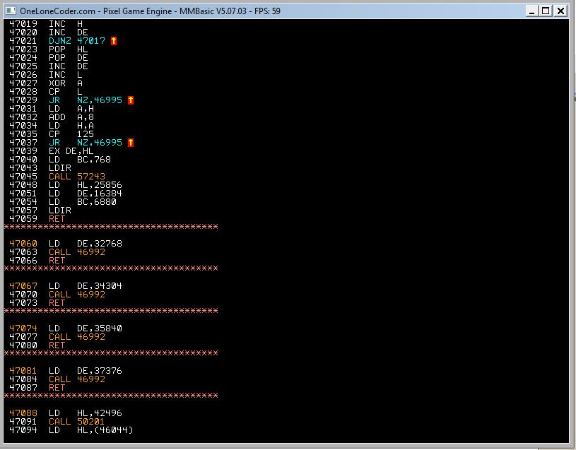

I wrote yet another Z80 disassembler (in MMBASIC4W). With undocumented instructions implemented.
It reads bin files (*.sna for example) and disassembles them, of course.
Now I would like to test it against errors. (I tested against some *sna files and it looks OK, but for example Ms.Pacman uses not so much undocumented instructions)
Of course, I could write my own asm bin, for testing, but it takes some few additional and boring hours.
I'm just wondering if there are any bins already created for this purpose. If yes, could anybody point me to a source or share?

Mick,
You are 100% right!
But I do not like unnecessary tabs! :D
Take a look, what my program outputs :
Basicly, the job is done in both ways, but I want formatted text like I prefer. (not the straight-forward way)
And for this reason, I preformed ED, FD, DDCB mnemonics in text files (tabs, spaces) in advance, so I would only replace 'NN' , 'N' values later. Now to reach what I want I use LEFT$, RIGHT$, but with pattern serach/replace, for ecample '#NN#' replace with '46009' final program would be more elegnat and easy to read and understand to somebody. Thats all buzz about :D
By the way - my rotating hobby of hobbies is reverse engineering old ZX Spectrum programs.
I can happily live with the bunch of b/w disassemblers we have already, but they are boring :D
