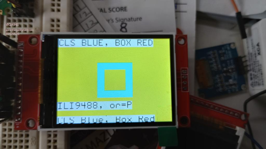

Progress of sorts!  Using ILI9481 gave rubbish for most of the screen but GUI TEST worked in a small area.
ILI9488 works sorta! Orientation is reversed, ie P=Landscape and colours are wrong.
However, it's a start.

I spoke too soon!
I plugged in an RTC and DS18B20 on the breadboard, and now the display doesn't work.
I disconnected them, still no go.
There is 4.84 on Vbus and 4.5B on Vsys.
