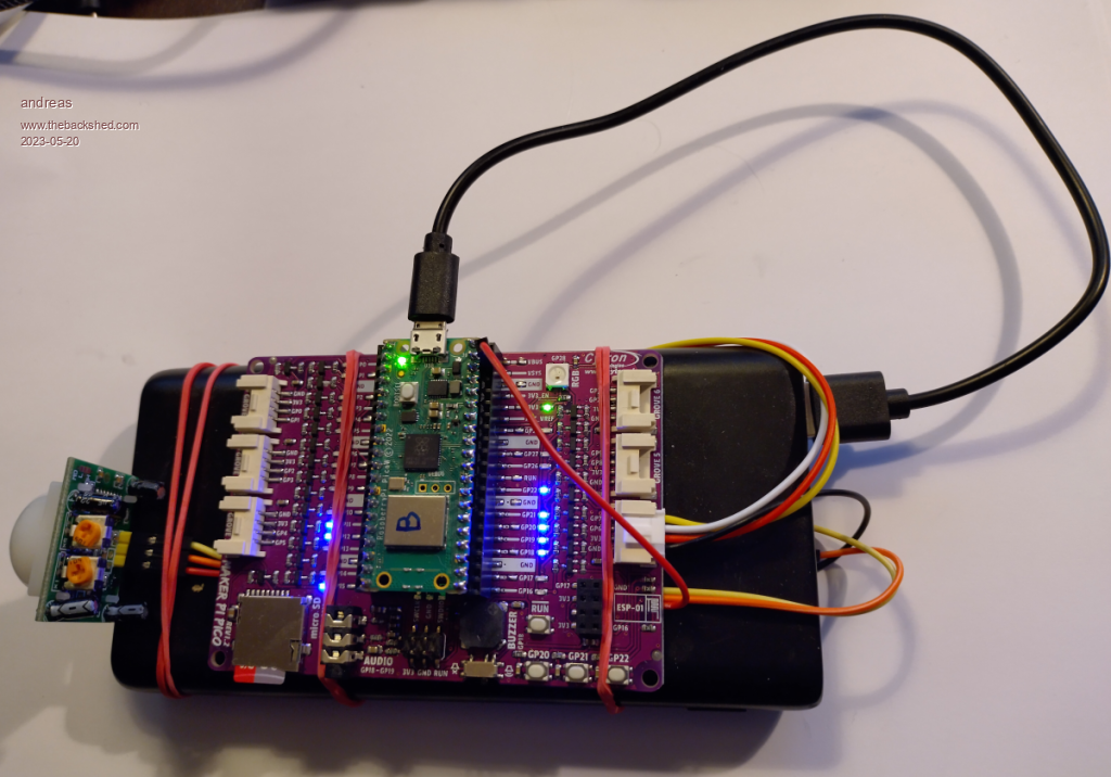

This pico w has connected a PIR motion sensor connected to pin gp6
I want to get the motion detection signals on any pc/mobile by using a mqtt subscription to a mqtt message broker.

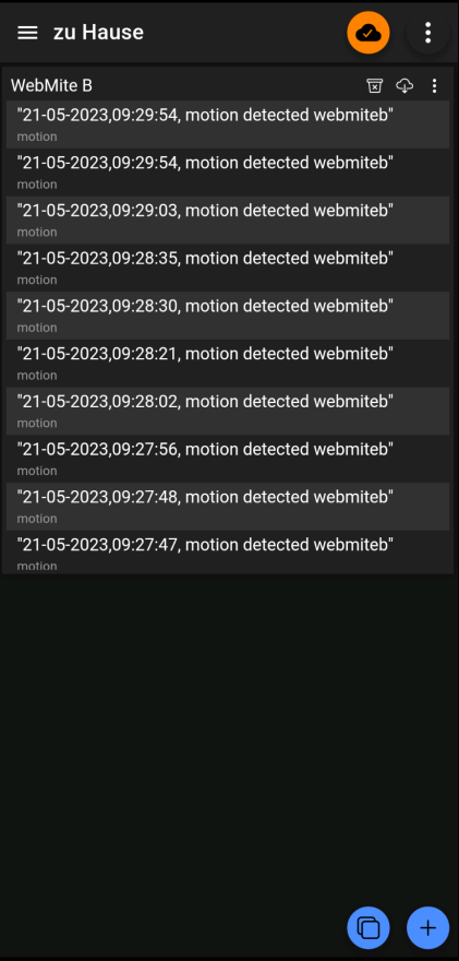

4. Receive messages on any pc connected to the MQTT server
Now I can use any other pc/mobile within my lan and subscribe to the motion messages:
first I install the MQTT client:
sudo apt install mosquitto-clients
then I can subscribe to the "motion" messages:
mosquitto_sub -h 192.168.178.54 -t motion
The host 192.168.178.54 is the raspberry pi acting as message broker.

And this is "webmiteb" the sensor pico connected to the PIR, akku and maker pi pico pcb.

By the way, I found a very nice Android app "IoT MQTT Panel" which works very good with the mosquitto MQTT broker on the raspberry Pi! There one can create a monitoring panel and add all the sensors.
I have a wireguard VPN between my mobile phone and the FritzBox - so I'm allways connected to my lan and can monitor the picos without opening a port or service to the WAN side of the FritzBox. Even my nextcloud is accessible from everywhere without opening a web port. ;-)
