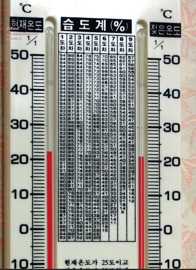

Looked at Wiki, found a picture that shows a physical device. My chineese is sub zero, but I think that the tables columns indicate the temperature difference and a certain level of the dry bulb (the wet bulb would normally not exceed 35C since humans would die, and there would be no-one to read the temperature).
This would require pretty accurate temperature measurement and calibration.
I'll play a bit with the idea. The good thing is that the wet bulb is easy to achieve since there are water pools in the habitat...

That Chinese table is the Mollier diagram to determine the humidity manually.
The two temperatures are measured with a ptc or ntc sensor.
In the greenhouses in my area (West of the Netherlands), measurement with dry/wet bulb is still used today, but due to regular maintenance, this is increasingly done with an electronic sensor.
The electronic versions have the disadvantage that they need to be calibrated, so it is more economical in practice to renew the entire sensor.
Two watertight DS18b20 sensors would work well and include the table in the microcontroller or by means of a formula. Do use good cotton stockings and a small auxiliary fan and demineralized water because the table is based on this.

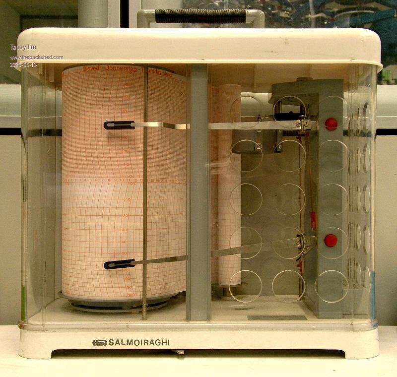

50 years ago I used thermo-hydrographs to record temperature and humidity.
The humidity pointer was controlled by a length of (usually) human hair.
I no longer have a supply of human hair to experiment with.
The drum was clockwork and the charts could be 24 hour or 7 days per revolution.
Edited 2023-05-13 10:45 by TassyJim

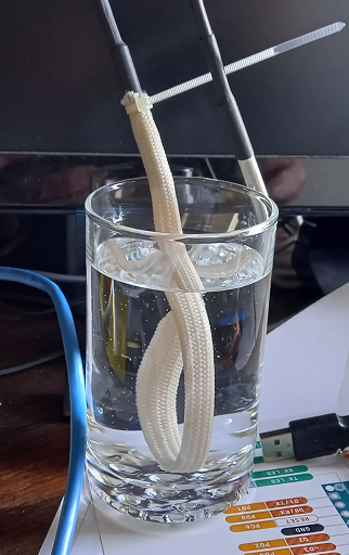

I am sure that if I look further, there will be many more variations on the net.
This uses a bootlace as the wick. Not the best choice but my wife's sewing basket didn't have anything better.
On my desk without any air movement, it reads about 10% higher than a DHT22
With a bit of breeze, it would come down nicely.
Edited 2023-05-13 15:36 by TassyJim

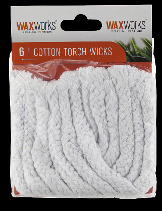

It is a long time since I have handled a genuine wick but the bootlace I am using feels too dense. I will find some better material to make a new wick before I get too involved with a fan.
I will try these.
Cheap and available at the local hardware store (Bunnings)
