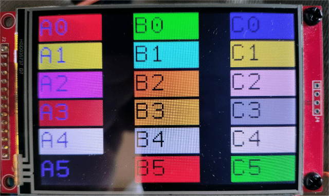

I like to lay things out in rows and columns (of varying widths) and then position items as fractions of mm.vres and mm.hres. For instance, with six equal rows and one column starting at zero, another centered at mm.hres/2, and a third right justified at mm.hres-1, the following code would produce this:
Dim string ch
Dim integer i,j,k,fnt,iRows=6,iCols=3
Dim integer b%(15)=(RGB(red), RGB(green), RGB(blue),0,0,0,0,0,0,0,0,0,0,0,0,0)
b%(3)=RGB(Yellow): b%(4)=RGB(cyan)
b%(5)=RGB(gold): b%(6)=RGB(magenta): b%(7)=RGB(brown): b%(8)=RGB(pink)
b%(9)=RGB(salmon): b%(10)=RGB(orange):b%(11)=RGB(grey):b%(12)=RGB(white)
b%(13)=RGB(lightgrey): b%(14)=RGB(beige): b%(15)=0 ' black
fnt=4
ch="A"
CLS
For i=0 To iRows-1
 Text 0,i*(MM.VRes/6),ch+Str$(i)+"  ",,fnt,3,b%(2),b%(j Mod 16)
 Inc j
 Text MM.HRes/2,i*(MM.VRes/6),Chr$(Asc(ch)+1)+Str$(i)+"  ",C,fnt,3,0,b%(j Mod 16)
 Inc j
 Text MM.HRes-1,i*(MM.VRes/6),Chr$(Asc(ch)+2)+Str$(i)+"  ",R,fnt,3,0,b%(j Mod 16)
 Inc j
Next i
This is on an ILI9488 with 480x320 resolution, but should work on an ILI9341 with 320x240 (maybe with change of scaling) or VGA or MMB4W.
Or like this:

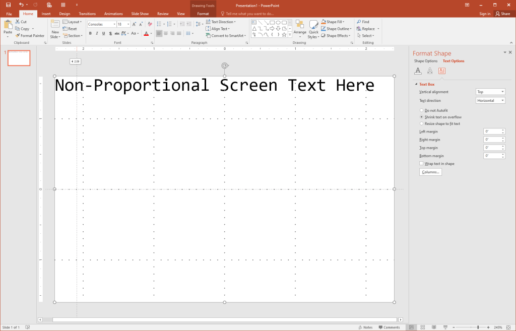

Powerpoint for me - I specify a layout (in inches, sorry) that corresponds to the screen dimensions (4.8"x3.2" for the 3.5" WaveShare Pico Eval Board LCD), then use the guides, rulers, size, and grouping tools to position items. Fixed (non-kerned, non-proportional) fonts come from the font selection drop-down, and I choose a font size that corresponds to the MMBasic fonts. I zoom the layout to fill my screen, and have at it.  The guides show me where things are on the screen.
