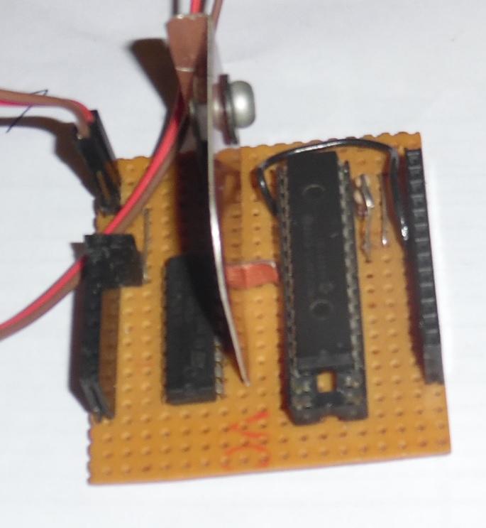

I found a mcp23017 .. which I thought was a pwm expander, doh.
It's got a uln driver for 2 4 phase motors. Why did I build it and not use it??
It got i2c pull ups and a 5V reg.
I can't find any code I wrote for it.

I found another 4 expander chips in a tube and lots of other forgotten stuff.

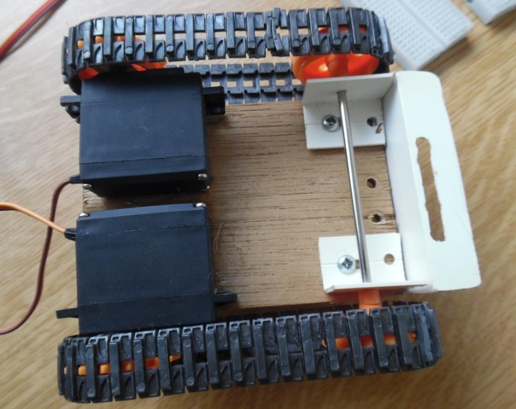

I looked at my "robot" code and it's an every 2mS timer overflow interrupt for the stepper motors and a counter that gives a 50Hz servo refresh, which isn't really needed as the servo is not under load.
I found a few abandoned projects when I found the mcp23017 chips, like this chassis that uses servos with the stops taken out for continuous rotation.

Posted: 03:05pm 10 May 2023
That's rather nice. :)
