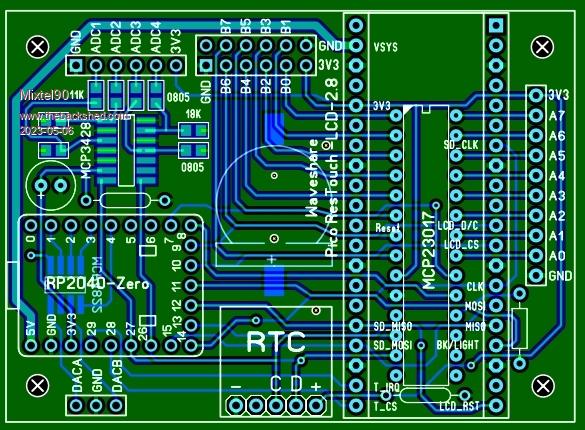

The problem with the Waveshare 2.8 LCD display is that, in spite of IO being spare, you can't connect to it very easily. I thought I'd do something about that. And add a bit just for fun. The only problem is that you have to use I2C for everything. :)
2x 8-bit GPIO ports
4x 16-bit ADC inputs
2x 12-bit DAC outputs
RTC
Space for a separate, accessible RTC battery
All on a piggy-back PCB that the display plugs into (or onto if you prefer).
I think I should add a 3V3 regulator for the GPIO though. The Zero has a 500mA regulator but the display, which is the one that I'm using, is only 300mA.
Nothing is checked properly. No proper design yet. This is just another "I wonder how much I can squeeze in?" project.  :)

It's the Waveshare RP2040-Zero and, unfortunately, all the necessary pins for VGA aren't available. It would use the normal PicoMite firmware as it's driving the LCD display. It would have to be either non-plug-in or use turned pin connectors as it has to fit underneath the display.
The 40-pin arrangement is 2off 20x1 male headers. The Waveshare display has female headers as it expects a Pico to be plugged into it. This PCB replaces the Pico. :)

A lot depends on what you want, Stan. The majority of modern chips are no longer available to fit breadboards of any sort - as a minimum you have to put them onto carrier boards. Also, if you want to use high speed stuff then breadboards are a strict no-no. You can't get them reliable over a couple of MHz simply because of capacitance between the connector strips and between the leads connecting them. The same goes for stripboard. You have to lay out very carefully as the frequency goes up and cut all unused lengths of strip (and sometimes the ones on each side). You can never produce an earthed isolation ring round a 40MHz crystal oscillator on a breadboard or stripboard. Certainly, if you want to produce something that someone else can copy (or you may want more than one of them yourself) then PCBs are the only sensible way if there are more than a dozen components. It's not just a matter of cost.
The board that's the subject of this thread was designed with a specific objective in mind. If you have one of those displays then you are probably frustrated at not being able to connect to the pins that Waveshare have left unused. The display is fine initially, but it's problematical if you want to put it to use, which is a pity. It's against my nature to throw out a good display because the original designer made it difficult to use.
I (mostly) don't design a PCB just for the sake of doing it. They may sometimes start out that way, but they almost all end up with a specific objective that would be awkward (or even impossible) to do on breadboard or stripboard. Whether you approve of there being so many different designs is immaterial to me - I'm not designing them for you as I know you prefer to mess with breadboard etc. :)

  Mixtel90 said  If you have one of those displays then you are probably frustrated at not being able to connect to the pins that Waveshare have left unused.
Pins unused on the display?
Sorry, I'm lost but what pins & what are they for?
Posts: 9086
Posted: 03:38pm 06 May 2023
When you plug a Pico into the Waveshare display (it plugs into a socket on the back)  only the pins needed for the LCD, touch, SDcard and Reset button are connected. Waveshare haven't left any sort of header to give the user access to the rest, which are simply unused.

Posts: 4372
Posted: 03:57pm 06 May 2023
Oh! It's Pico pins that are unused. I thought you meant display board pins and wondered what else it had.
Makes sense to bring them out to pins/connector(s). Weird they didn't.
