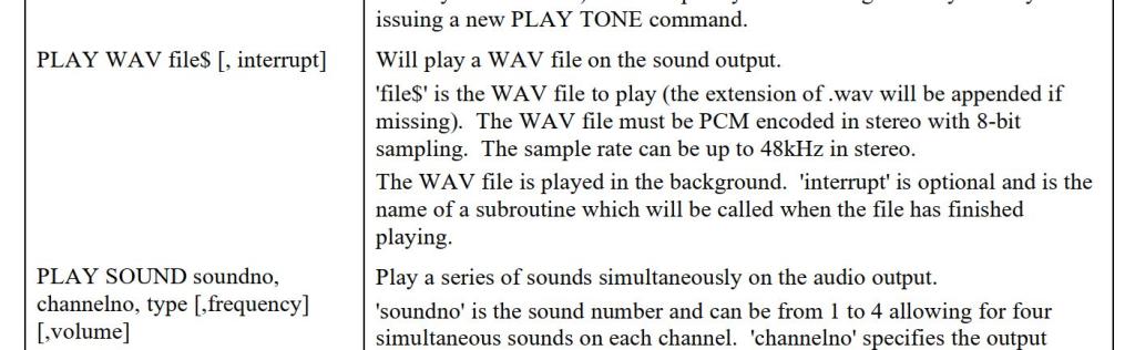

8-bit thing came from manual(5.07.06, Rev 1), page 112:
Perhaps the manual is simply out of date now with respect to the new DAC feature etc.

It is and will be fixed.  Thanks.
