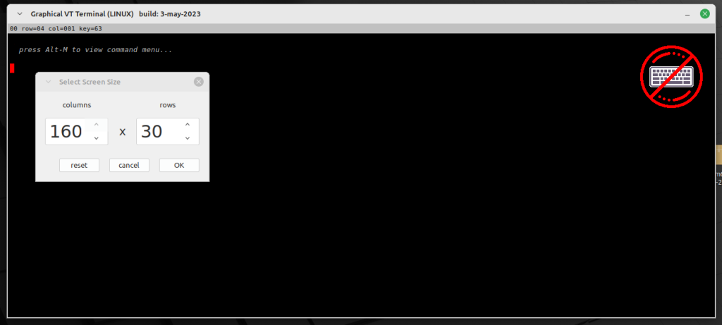

attached are test versions of GFXterm compiled for 64-bit linux and win32. these have a couple of changes requested by Frank N. Furter:
1. anything being pasted that is only one line long now does NOT have a carriage return appended, and,
2. there is now a new menu option, "screen size" that enables you to manually set the screen size to anything between 40x16 and 160x60. this should accommodate the needs of the pico versions of MMbasic.
there have also been a few bug fixes, but since no one noticed them i'll not go into details
i have NOT extensively tested the changes, so these versions should be strictly treated as experimental. please do report any odd behavior you notice. allowing for user settable screen size was a tad challenging, and may have unexpected side effects. what testing i did was with an MX170 micromite and mostly involved odd numbers of columns.
