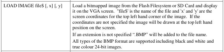

The good news is that I found out how to fix my problem.  I re-saved my indexed BMP file as an RGB format BMP file and it loaded exactly as expected.
So sorry @geoffg and @matherp, I'm not sure if it's a bug, or a feature, but unfortunately the statement in the manual that LOAD IMAGE supports all formats of BMP files doesn't seem to be the case.  So it's either a change in code or a change in the manual.  No guesses which is easier.

Posted: 08:24am 29 Apr 2023
The firmware definitely supports indexed files as I've been using them recently and even supports compressed indexed 16 colour files

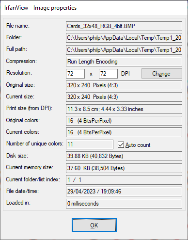

Used
save compressed image "Cards_32x48_RGB_4bit.BMP"
Cards_32x48_RGB_4bit.zip
Now it's 40kB

IrfanView and Paint can display it ok but black & green on the pico.
The size is too big, 416 x 240 pixels. 320 x 240 max.
For processing your 24 bit images put them on a SD card and use the PicoVGA 'Save Image' to convert them to 4 bit. 'Save Compressed Image' uses run length encoding to shrink them further.

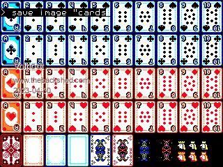

Hi Phil99, Hawk,
Phil, your conversion worked. I was able to load the BMP and it shows all cards from Ace to 10, and some rear sides and jokers. It does not show the king, queen and jack.
That must be in the par you did not convert... (320...416)
Using 5.07.07RC6 on picomite VGA
mode 2
load image "Cards_32x48_RGB_4bit.BMP"

I cut off the last 3 columns of cards (using IrfanView) and it displays correctly on the VGA now, though I don't know if it retained the indexing. As all the cards are the same size they can be easily separately displayed using multiples of their dimensions to select them.
