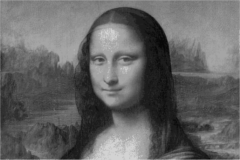

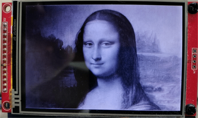

Thanks, John. I'm afraid I would need an actual schematic (sketched out however).
Here is a Mona Lisa image I clipped to 3-wide by 2-high, scaled to 480x320 for an ILI9488, and transformed to greyscale with PaintShopPro. PSP reports 218 colors. Here is how the PicoMite presents it:
I think that is pretty good, and the moire patterns shown in the photo aren't evident on the ILI9488. (Actually, the moire patterns I saw on my screen don't show up on the TBS page.)
218 is a lot of grey resolution, so in PSP I reduced it to 16 colors. Not so good looking, but not bad. It would be better if the white were bumped up to the next grey level so the forehead and other highlights weren't white.
How would this compare to PicoMiteVGA greyscale_x_16?
