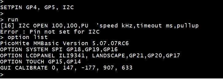

SETPIN GP4, GP5, I2C
> run
[16] I2C OPEN 100,100,PU  'speed kHz,timeout ms,pullup
Error : Pin not set for I2C
This is my options
Anyone got any ideas how to fix it?
Posts: 12082
Posted: 11:42am 25 Apr 2023
The setpin needs to be in the program

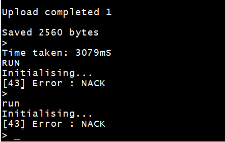

This is what I get when I run it
Edit: I have buzzed out the connections and they are all correct
