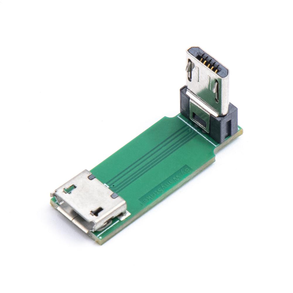

You can get adapter leads from USB-A male to RJ45 female especially for this sort of thing (on Amazon). Whether one would fit in the box, together with another adapter to micro USB, is something else entirely.  :)

I have decided I will try to utilise one of these adapters as on reflection an extension cable would be difficult to mount in my enclosure (The enclosure looks big but the way its designed there isnt a lot of room inside).
I have one here and it is very small so I could hang it out the bottom from an accurately drilled hole and pop a `bung' in the hole when not in use.

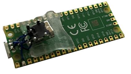

Posted: 04:17am 28 Apr 2023
Hi Mick (The Other One), All,
Well,
I have just tested the pads on the underside with this very rushed bodge job of mounting a MINI-USB with a bit of double sided tape/goop.
Why did I use a MINI? Well I had a 3m and 5m cable of USB-A (full size) to mini Male cables.
And I first tried with a 3m cable and was able to flash an old version firmware,
I then tried a 5m cable, that wouldn't work with my car camera, and I am happy to say that the firmware flashed perfectly.
I am amazed. I now need to look at what is the best way to provide this option.
As I said, Space is at a premium inside the weather station (commercial unit I stripped down) so I may not be able to fit a short m-F cable/socket into the unit easilly but a few soldered wires is a different matter. I could just cut the connector off the end on the cable and have 5m dangling down the pole but I really want to have this socketed so I could pull the unit down for maintenance when needed.
Anyway that is looking like a reasonable option for me to run with.
