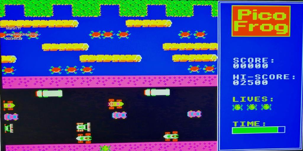

The playable version of a Fogger style game for the PicoMite VGA.
The concept of Frogger is simple. Just get that frog from A to B. Yet it’s a challenge to execute.
The Game:
Move your frog carefuly. Avoid the moving vehicles. On the river, jump across the logs to get your frog to its “frog home”. There are five of these homes, so you have to repeat this four more times.
The Program:
This is the basic structure of the game. What is missing  in this Version are levels, lady-frog, crocodiles, Beaver, Flies and diving Turtles. So there is a lot of room for improvement. Developed on PicoMite Version 5.07.05RC..

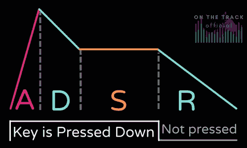

Do you think it would be possible to bring the ADSR from 10 to 5 ,6, or 7 steps ?
That would allow a slower SETIICK (from 23ms to 46/38/33ms) which is less CPU intense in relation to the FRAMEBUFFER MERGE. It may be able to run on a GM at 252MHz then.
EDIT: I tried ADSR of 5, and it sounds a bit raw, but runs perfect at a Game*Mite 2040  at 252MHz. So maybe I'll keep this as an Game*Mite options (platform based select).
Edited 2025-08-22 19:59 by Volhout
Martin H.
Joined: 04/06/2022
Posts: 1573
Posted: 11:30am 22 Aug 2025
These were values used to approximate the envelope curve.
It therefore describes the volume of a tone over time as it is played.
The fewer values you use, the closer you get to a simple rectangle,
but you can try this if it makes music run more smoothly.
Edited 2025-08-22 21:33 by Martin H.
'no comment
Posts: 6195
Posted: 11:44am 22 Aug 2025
Please find attached version that uses a 7 stage ADSR for the main music for RP2040, and 10 stage for RP2350. This works well for sound on both Game*Mite platforms.
Both platforms use the default Game*Mite CPUSPEED = 252000.
