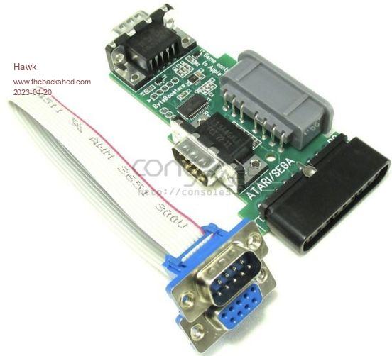

Posted: 07:31am 20 Apr 2023
Here's an example of how the SNES connector could be mounted to a PCB.  Note that the PCB has a cutout for the over-hanging flange of the connector.  The pins are extra thick, but to create a better mechanical attachment, a wire could be soldered across the top of the connector closer to the edge of the PCB.
Photo courtesy of console5.com.
Edited 2023-04-20 17:33 by Hawk
Posts: 9086
Posted: 08:00am 20 Apr 2023
Oh, just go ahead and invent your own standard. There are plenty to choose from, what's one more?
At the end of the day this is *your* project, Mike. If you wait for an actual standard to appear you may never get to build it. We've been waiting for a while now.  :)
Personally, just at the moment, I think the implementation of the NES system used on the PicoGAME is probably the best. It's using six pins though and I'd like to see that reduced to four as I consider it wasteful. I couldn't get the tracks to play ball on that board though.
As it's unlikely that anything else will be used at the same time I'll suggest this as the new "standard" controller system and see if anyone would like to hack it to bits:

Posts: 6059
Posted: 06:41am 21 Apr 2023
Would this help ???
connector
p.s. the game console using controllers should be sturdy, big and heavy. I understand there are amongst us that want the benefit of cheap JLC pcb's and make everything small, but people playing games would want the controller to move, and rest of the setup to be fixed (to avoid monitors smashing to the ground at the moment of exitement).
I personally would not suggest to people that cannot solder SMT (majority of this forum) to start modification on the cheap NES controllers I have seen, just to connect it to a different telephone "alike" cable.
I admire your energy Mick, and I will follow if this is the forum direction, but I am hesitant to support what you are proposing.
